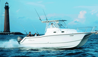

    From a users point of view (rather than a designer/builder etc) my priorities in a 55 ft boat would be:
    good usable cockpit. Now this becomes a bit of a problem in a cat due to the clearance needed between the hulls. Esp in a sportfish model. Also, too many builders IMO put too much fixed seating in the ckpit.
    If there is a lower station & the vessel is over 50 ft, then access from the lwr station to the sides/bow as in a pilothouse. This in turn forces the design to enable wider access on the side decks, a great feature. OK you sacrifice saloon area etc, but it is a good trade off.
    Too many cats have that "caravan" look/feel internally.
    Cabins, especially master need an island bed, another issue with the usual narrow hulls.
    Styling IMO, NO MORE teardrop windows!!! If the style is different from the "norm" it will not matter if it follows function.
    Like this boat: 53’ Cat Cay ~ 2004
