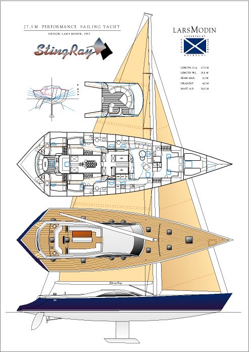

    Sting Ray
    Today I´ll give you a sailing yacht! It is 90 feet/27.5 m and has a hull where I have combined a low drag at light winds with high beam stability at strong winds. The sharp V-shape seen from above will, at least in theory, help to give planing effects at higher speeds without adding too much wet surface. Boats with wide planing hulls like the W60:s normally has to carry more sails and usually a more experienced and active crew. My hull shape should be more easy to sail, less risk for broaches and still with some speed thrills.
    Interior is with a raised wheelhouse open to the salon. Master cabin forward, two guest cabins midships and crew area for four in the stern.
    Main engine and generators are in two rooms for safety and she could have a lift keel for shallow waters.
    It has matured seven years in my computer, any feedback from you out there, bad or good is both welcome and appreciated!
    Lars

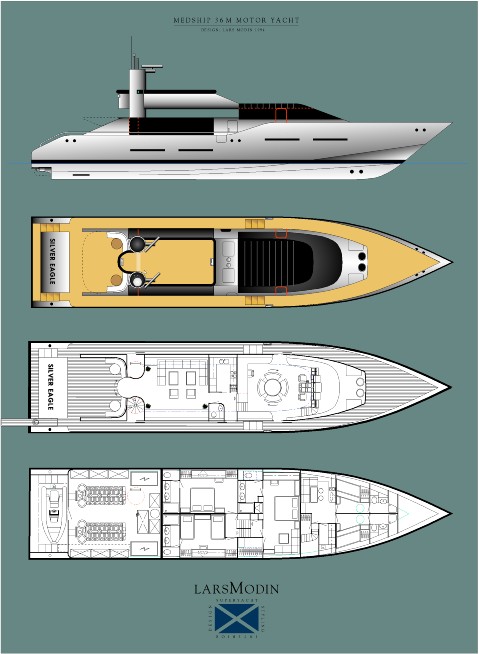

    36 M Stealth Yacht
    This design is one of my older, made in 1994, but still pretty modern if not avantgarde.
    It is a 36 m (118 feet) high speed, high tech yacht. Should cruise in comfort at 35 knots and top out at 50 with diesel engines and waterjets.
    Accommodation is for six with a crew of up to four.
    The round table in the large wheelhouse is both for dining and observation under way. It is built on a revolving platform, that slowly changes the scenery so you can enjoy the 340 degree view. Yes the flybridge is really "flying" so you have a free view aft as well.
    The glass parts of the superstructure is with solar panels and LCD rasters to keep sunrays and paparazzi out of vision.
    If you don´t want to order just another Wally 118, this one might be an option? ;)

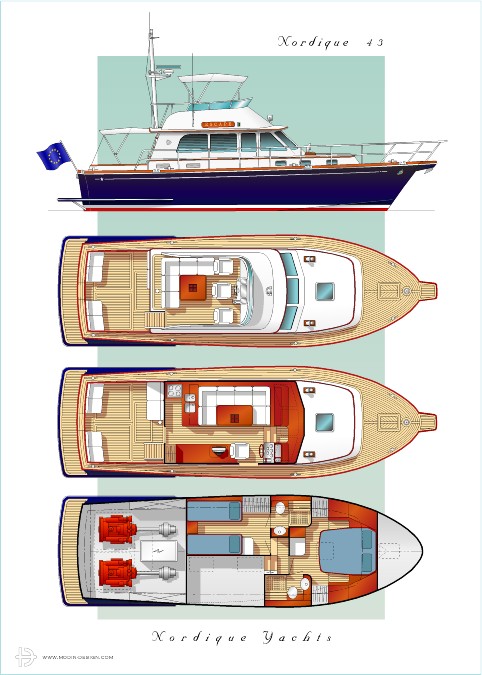

    Nordique 43 Fly
    A traditional boat in many ways, in a size most people can handle themselves, designed only three years ago. She has just two cabins, offering real bathrooms with separate showers. A large utility room with space for a watermaker, air condition or just for storage. The salon has a galley to port so it is easy to pass, and the whole boat is made with as few compromises as possible.
    She can cruise in any speed up to 24 knots depending on what range you need.
    Together with three other boats in the same line, 33, 41 and 50 feet, she is looking for a producer... :)

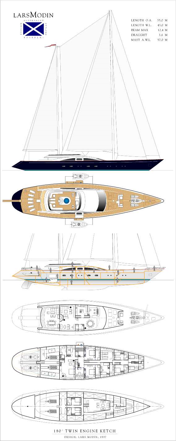

    Ketch 55 m / 180 feet
    The system with captive winches has made it possible to build big sailing boats and motor sailers that can be sailed with a small crew. When I made this design I thought she was very big. Today we have seen Mirabella V breaking all records and several 180 footers are already sailing.
    Nevertheless, it might be interesting to have a look inside one of the yachts I am still anxious to see being realized :)

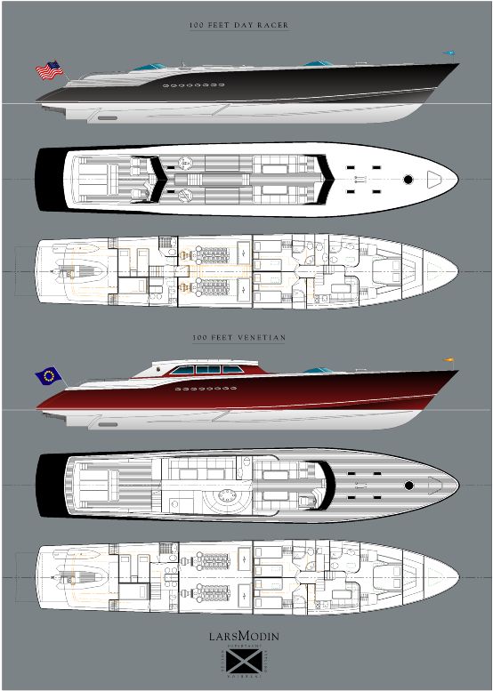

    100 feet/30 m Day Racer & Venetian
    Going from Miami to Bimini for lunch? Or between St Tropez and Portofino a sunny afternoon? This is the boat for you.
    The open version has an aft cockpit for the crew, allowing the guests to enjoy the speed thrills in the forward section.
    The Venetian version has the main cockpit in front of the air conditioned salon. Both models have three staterooms for six guests and crew accommodation for three.
    The propulsion could be waterjets or surface props allowing top speeds of up to 60+ knots and cruising up to 50 knots.
    These two 100-footers will turn heads! :cool:

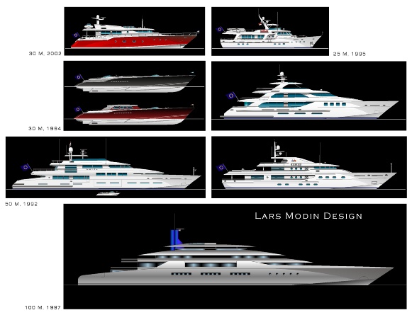

  16. Rene GER
    Rene GER Senior Member
    Sep 4, 2004
    739
    Northern Germany, West Coast
    My favourite is the Modin 100M. 1997. VERY COOL :cool: :cool: :cool: :cool: I'm exited.

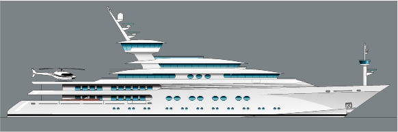

    However the styling of this 100 m yacht started as something completely different, what do you say of this one;
      54.9 KB
      5,953
  18. Rene GER
    Sep 4, 2004
    739
    Hi AMG,
    I don't like the superstructrure, but the hull is very nice!
    René
  19. AMG
    5,392
    I can agree, she looks quite boxy as you see her, but from above she was canoe-shaped in both hull and superstructure!
    With polished stainless steel panels, glossy black windows and hull, and the funnels matt-finished in red.
    She would make a real showstopper, but somebody has to be brave (and rich) enough to build her first...! :cool:
