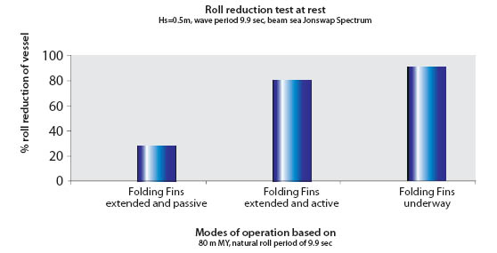

    Rolls-Royce is developing a new concept that significantly reduces the roll of a motor yacht when stationary by increasing the effectiveness of the folding fin stabilizers normally used for underway stabilization. The system uses a different fin profile and an advanced control system that keeps the fins ‘active’ when stationary, maximizing their effect in reducing ship motion. Scale model tests carried out at the Maritime Research Institute Netherlands (MARIN) in Wageningen December 2005 on a large motor yacht have proven the effectiveness of the design concept. The conclusion was: "The Innovative Rolls-Royce system works equally as well as similar systems currently on the market."

    • 20-30% increase in performance when fins are passive

    During the trials program a number of different fin geometries, actuation speeds and control algorithms were tested and the data analyzed to determine the best overall configuration. Further testing on other projects has recorded similar roll reductions. An extract from the MARIN report stated "One pair of modified Aquarius stabilizers provides similar performance to two pairs of low aspect ratio fins."

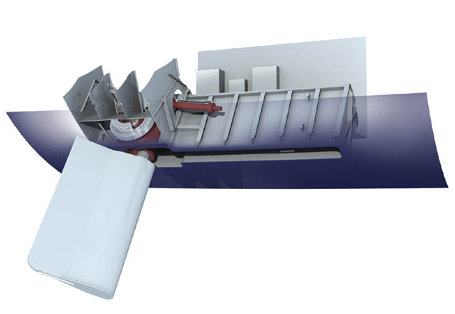

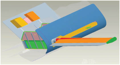

    Two Aquarius Folding Fin stabilizers are the key components to the system. Each stabilizer has a modified fin profile, as seen here...
