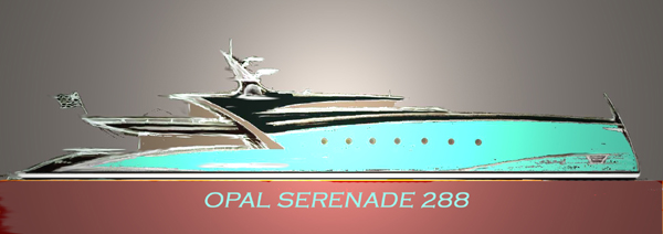

This was my Coventry University Final Project. Indeed the initial idea for the reverse bow was a styling element but this 50m yacht was designed to be fast so her bow would raise at speed. The previous thread was correct however in saying that youd be drowned if standing on the forward deck area when in motion.
