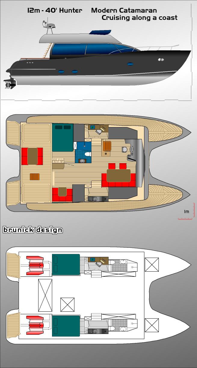

    hi guys
    it took some time (tonight) but i think its nice little cat *g*
    just take a look ;)
    (don't mention the engines, i don't know how to draw them *g*
  13. KCook
    KCook Senior Member
    Jun 24, 2005
    1,159
    Phoenix
    Looks slightly front heavy to me. Especially for a cat. I would be tempted to slide the superstructure aft a little. Even though that would likely not leave room for the big table on the aft cockpit deck.
    Kelly Cook
  14. brunick
    brunick Senior Member
    Jul 15, 2005
    637
    earth
    kelly, you're right, its very front heavy, but i think before i move the superstructure back, i will made the hull a bit longer, because i like the table on the stern. at the stern isn't a cockpit, there should be a fly bridge but i haven't drawn it yet.
    maybe i will just slide the fly bridge a bit aft. i will try it the next days ;)
  15. KCook
    KCook Senior Member
    Jun 24, 2005
    1,159
    Phoenix
    Stretching the bow further forward would certainly be a fix. But at the same time I think I would want to also raise the level of the gunnel/sheerline. At least in the bow. A cat hull design that is too low a profile will be at risk in big waves.
    Kelly
  16. AMG
    5,386
    If you extend it forward of the windscreen, you can also get a useful "cat-walk" between the hulls...

  18. brunick
    Jul 15, 2005
    637
    earth
    version 4, what about this one?
    for me it looks a bit more like sport-fish yacht
    kelly? would you build this one? ;)
    EDIT: i forgot to make the new length....
    its 13.5m now - 45'
