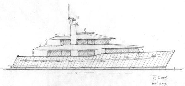

In sticking with the TRY brief, at 30m, I submit the following.
I always start with a freehand pencil sketch to establish where we might be going. I will often submit 10-20 of these quick sketches to a client and see if any strike some interest. Often some will be judged terrible and some okay, then I'll try to combine features of the okay profiles. Then we start looking at arrangements, and end up re-doing the profile all over again. And so it goes.
Tad

Hi Tad,
The online design game is just for fun, see how people react to the powercat idea.
Nothing professional here.
Sorry if my previous reactions were misleading!

TRY,
I think I get your meaning.
If boat design was not fun, I wouldn't bother. The conceptual part is the most fun of all, as after that follows hundreds of hours of hard work. The simple pleasure of making a little sketch without regard for how to manage all the owner's requirements, the builder's budgetary problems, the regulatory requirements, the interior designer's demands, etc.
This is fun, a holiday in fact.
All the best, Tad
