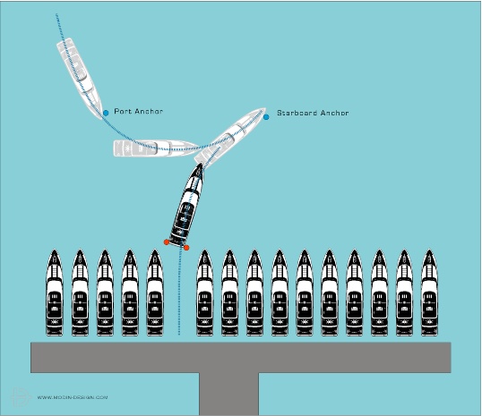

I might not understand the question, but you use one or two anchors that you later exchange for groundtackle. In some ports you don´t use anchors at all. The harbour master will tell you over the VHF or cellphone in advance.
Below I have added a picture of a typical mooring at the Monaco T-Jetée. You need one or two guys at the anchors and two for the aft baloon fenders and throw-lines. Normally captain is on the starboard wing station giving signs to the anchor guy and getting information on distance to quai from the mate on aft deck through VHF or intercom. The whole thing takes less than five minutes. Piece of cake...
Would you like more details or anything else around it, or did I get you all wrong?

The Airbag...
As I said above, in some ports the staff will meet you with a tender to hand over the fixed mooring lines so you don´t have to anchor at all.
In Monaco, after you have anchored, you have to contact the Diver (on VHF) who will attach lines to fixed positions on the seabed. Then he will connect an airbag to your anchor, fill it from his tubes and the anchor will "float" as you winch it in.
When you leave the port, just drop the lines and you have no anchor tangle with your neighbours...
