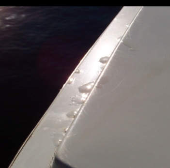

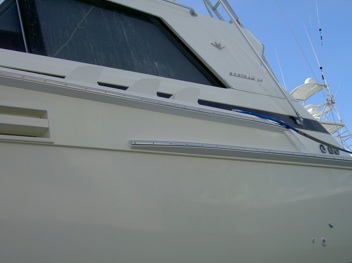

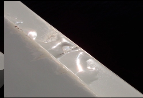

I am re-caulking the rub rail this winter and I noticed the paint on rail is in bad shape. Anybody know what type of paint to use on it?

I called Jamestown Distributors and they said any topside paint would work , but as suspected with any paint job they said sanding would make or break it. The top side of a rub rail is hard to sand without scratching other surfaces so they also suggested a primer first to fill in some of the craking etc...

I looked into sanding and re-awlgripping the aluminum rubrails on my 54 Bertram .. just to do the cockpit area with an expected life of 3 years was going to be $4500.00 ... I'm now looking into a PVC product with stainless cap designed to solve the problem for good. I'll start with the cockpit area and do the rest in a year or two.
