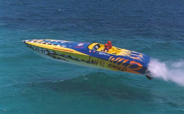

    Dave,
    A Whaler is only good for one thing... exchanging horizontal velocity for vertical trajectory! If you're towing a Whaler at 22 knots... behind a 50' Bertram... your son is missing a whole lotta fun.
    How is he suppose to follow in his father's footsteps if you don't let him prove a Whaler is unsinkable? Isn't this you in the picture below? Like father, like son... ;)

    As a matter of fact Carl, if you look closely at that picture, you will see the tow line behind my old race boat. We would tow the whaler during the race "just in case":rolleyes:
    I know I'm going to hear "daddy, I want to ride on the whaler" when it's behind us.
