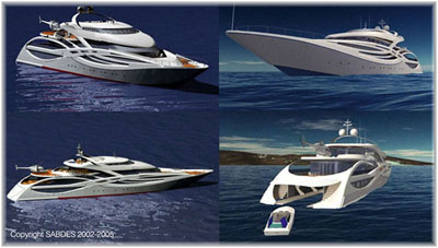

RADICAL New Hull Design...
A 70metre concept produced for an Aussie client. The design proposes a float-in-tender dock which can be used as a swimming pool, with bomb doors / a central atrium thru 4 decks / expansive use of glass / curvaceous styling which is integral to the structural elements as well as being aesthetic.
This design pushes the envelope in regard to concept and styling for new Superyacht proposals, and doesnt try to adhere to any rules so the creative objective could be realised.

Who's building it? Will it have the 'wave piercer' design?

SABDES 70
The hullform for the SABDES 70 is a planing monohull form, though along the way we did develop an original idea for a hull which morphs a monohull with cat-pods aft as seen in attache piccy; the purpose so the float-in-dock would be open all the time without need to flood. The wavepiercer hullform didnt suit the concept ideas correctly, though there is a trimaran hull seen on the NWBS yachts 61m E-motion was considered ok.

You're saying that 220' hull will plane off??? WOW!!
I saw the E-Motion in Boats USA magazine(Dec. issue). That hullform design will provide lift and stability, thus reducing power needed for operation, and increasing fuel efficiency.
I like the design of your vessel, very modern and forward-looking. I like the "cat-pods" idea too. Innovation is key to sales, especially when it's out there for all to see.
Two thumbs-up from the catman!

... anything will plane if it goes fast enough... maybe, as the song goes... 'with a little bit of help from my gasturbines'.

That hull seems pretty radical.
I designed a boat last year with two engine pods kinda 117 Blackbird style. If i can find an image on my back-up cd, i'll upload it.
I certainly think it would be really neat to see something like this for real. Interesting to see how it would look, and work, with stress and strain points, etc.

The B&V yacht Eco/Enigma of the same size is having twin diesels of 5.000 hp and a gasturbine of 18.500 hp. They still needed a foil added under the stern to get her "planing", so it isn´t that easy...

It appears to me to be kind of a revolution in hull design. The shape is quite unusual, and not only for the stern.
I bet it's gonna work very well...

To push a 63 mtr yacht with a displacement of 500 tons (very very light weight construction) you need approx 40.000 hp to push her up to a little above 40 knots;
Frank Mulder proved with "Moonraker" that those speeds are not unreal to achieve, however if the yacht gets larger, other and bigger problems are popping up.
Next to that, what is the advantage of a yacht at planing speed: even a destroyer, capable of doing 40 knot+ doesn't plane..... I am a little sceptical but I am involved in the making of fast moving surface vessels.
BTW - the later owners of Moonraker took out the gasturbo..... the high speeds were intolerable........for crew and passengers.....

A number of years ago, I worked with a research team that utilized the facilities of the David Taylor Research Center; the Carderock Labs in Bethesda, Maryland and the Large Cavitation Channel in Memphis, Tennessee. These facilities are funded by the Department of the Navy, as was our research group.
We used the High Speed Basin in Bethesda to analyze hull and foil development, while the Memphis facility was used for propulsor and appendage studies. Most of my work was conducted in the fields of water-jet propulsion and high speed hull designs.
I've got a little more knowledge than the average park bear in this area and after studying your monohull-sponson concept, it may be one of the most revolutionary hull designs I've seen in years.
There appears to be many benefits, beyond tender deployment...
1. An exceptionally low drag coefficent.
2. Inherent stability.
3. Displacement efficiency with planing cabability.
I'm confident that this configuration could achieve plane, and may not require the horsepower that others have speculated on. There are a couple of ideas that come to mind that may aid in achieving plane...
1. A stepped surface to break adhesion or a re-vamp of the main hull aft section.
3. A keel level pad. This would have no real adverse effect on displacement efficiency, but would help develop lift for planing speeds.
Any of these combinations would result in a 3-point lifting surface. There is one reservation that comes to mind... there may be some bow-wave interactions associated with the sponsons that will not be favorable. Tank testing could isolate any occurences and modifications of the sponsons could help reduce this interaction.
Setting aside planing speeds, which is not a high priority for yachts, the real advantage to this hull shape appears to be for displacement speeds. I for one... applaud your design.

Thanks for the positive review... its great to hear your comments are reinforcing the whole ideas behind the hull shape which would also provide good at-anchor stability due the triangulated footprint, ie:main hull and 2 sponsons. The achievable speeds of the hull form would need full tank testing, which hasnt been done as yet, before deciding what its operational best would be. A semi-displacement speed range (18-25knots for 50m/165' hull) may be its best category, with improved fuel efficiency achievements; it would make a strong alternative to a traditional mono-hull, with some of the advantages (but none of the, debatable!, aesthetic issues) of using a tri of cat hull, for a Superyacht. To achieve high speed 30+knots, it may also work with a T-foil fwd, or hydro foil fwd, to provide some extra lift, and a flat plane between the sponsons aft... I agree the interaction of the sponsons would need looking at the results. As they are shown they are made wider than the monohull to increase stability, and could be made less. The approx ratio lengthwise of monohull is 75%, to the cat sponsons about 25%, thus keeping good inherent stability. The design lends itself well to waterjet propulsion. The 70metre SABDES design, we realistically proposed twin 6000hp diesel engines driving CPP to provide speeds in the range of 25+ knots... and a booster gas turbine for anything 35+ range for the non-wimps out there!

Quote:
Initially, this was my first thought as well. But...
Shafted propulsion in the monohull section would not be favorable due to trim and CG considerations. However, waterjet propulsion in the sponsons may have their own challenges as well...
If the sponsons are running in a turbulated flow, induced by the bow wave, the intake gullets of the pumps may be prone to ventilation. This may be further compounded by the recessed (raised) position of the sponsons.
Typically, jet pumps are most efficient when placed at keel level, or the deepest section of the hull. They are prone to loosing vacuum when placed outboard, generally because this is a more aerated section AND because any lateral hull oscillation can break intake vacuum on one side, or the other. With a tri-hull configuration, this will most likely result in constant course variations while operating in rougher water. (On a more positive note, this might be the first hull ever developed that would allow jet pumps to work effectively in reverse, as there is no hull interference for backwash.)
I'm leaning toward traditional shaft propulsion in the sponsons for several reasons...
1. The depth of the shaft (and ultimately props) will offset the raised position of the sponsons, placing the props deeper than a jet pump. Aeration considerations would be minimized, as would course variation.
2. The angle at which the shaft exits the sponsons, which ultimately induces negative trim into the bow, is compensated by the extended length of the sponsons. In other words... the longer the boat, the less trim is induced by shafted propulsion.
3. As a planing hull, surface drives might be an option. Typically, surface drives sacrifice low-speed maneuverability, but the width of drive placement with outboard sponsons, coupled with no reverse-backwash resistance, might prove to be a favorable platform for these drives.
These are just some random thoughts. It's not my intent to "critique" your work. It's the first new hull design to capture my imagination in years and I enjoy exploring the possibilities.
