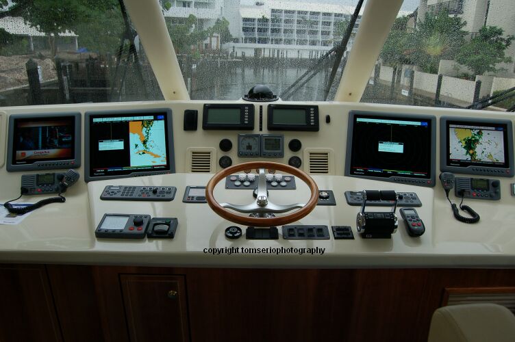

    I did a product review for one of the magazines I write for on the new Raymarine G series. Took a ride during FLIBS on a 65 Ocean fully fitted with several G-series displays and all other Raymarine items.
    I was very surprised to see a much faster refresh rate as compared to the E-series. Nice vivid colors in bright daylight. The G-series is meant for larger vessels, as the screens are large and the brains of the system take some space under the helm or in a closet.
    Here's a shot of the helm.
