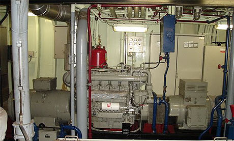

    Custom sound enclosure for Deutz
    Well, this is not a typical generator.
    It's a Deutz 1015C engine, driving a A/C generator on one end and a DC generator on the other end (for bow truster).
    So, not a stock item. See attached pictures.
