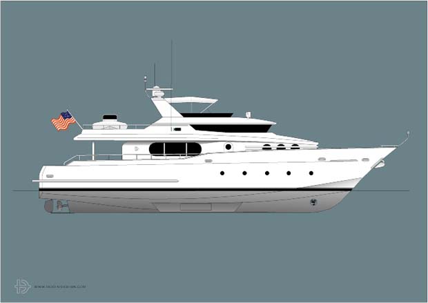

I think the reason we donīt see bilge keels on yachts is that they interfere with the active stabilizer fins. On a trawler design I have made the active fins as a part of the bilge keels, thus redirecting the flow in the middle of the keels which may be a good solution. Canīt find the drawing now, but it is posted here somewhere...

I suggested passive stabilization in our last refit, but the finances wouldn't cover it. I already have active stabs and I planned to run two passives on each side of the hull, aft and forward of the active but on the same plane. How will this affect the active stabs? Should I consider one longer passive each side below the lines of the active?

Your idea is in essence what I had in the old design I just found. The moving part is also attached to a bar connecting the two fixed keels as a protection and to make all of it more stable. I think it should work really well if installed at the right positions...

in the image the passive appear to run a little deeper than the active, is that what you would suggest? My idea wasn't to encase them the way you have but I could see how this would work well. They passive I'd planned to be about half as deep as the active.
Would you keep the passive straight or curve them to the shape of the hull?

These bilge keels are angled outwards about 30 degrees from the centre and must remain straight when you look at them from the front so they donīt act as rudders. As you probably know it can be hard enough to get your rudder(s) or rather the autopilote and the active stabilizers to work nicely together.
The moving fin is enclosed to not catch fishing gear so easy and this whole setup is also fine where you want to dock at ebbtide.
The shaft for the fin is a little forward, off centered.
For a pure yacht such as yours, I think bilge keels half as deep as your fins is a good start. It will not be so expensive to modify later if you so wish.
