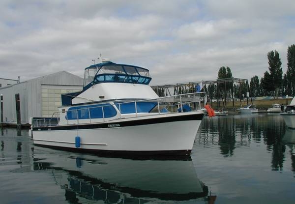

  8. newbee
    newbee New Member
    Dec 6, 2004
    61
    West Coast
    Let's see if I can figure out how to post a picture of the old girl.
    Well what do you know....it worked

    Nice looking boat....worth fussing over.
