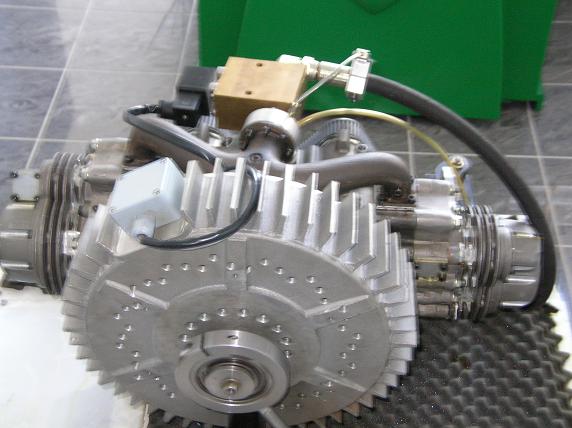

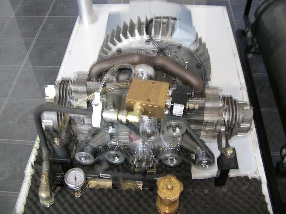

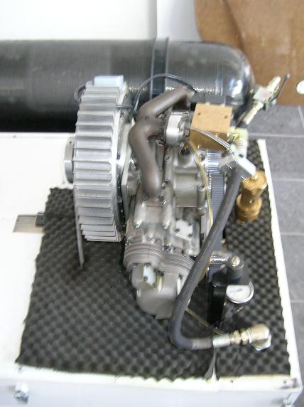

Old 01-09-2007, 06:00 AM   #37
TRY
Senior Member
TRY's Avatar
Join Date: Sep 2004
Location: cannes
Posts: 295
Photographs
As promised before the "quiet period" I post some (very bad quality) photos of the air-genset we use for further development and demos.
It develops approx 6kva for 0.6 x 0.6 x 0.4 meters and some 60 kgs.
More detailed specs will be posted later today (or tomorrow).

Old 01-10-2007, 01:41 PM   #38
TRY
Senior Member
TRY's Avatar
Join Date: Sep 2004
Location: cannes
Posts: 295
Some specs
The specs relate to the genset configuration as shown with photographs yesterday.
The engine part is a flat twin of 600cm3.
2 or 3 engines can be connected mechanically to increase volume and power output.
Therefore the flat-four version can be extended to flat-8 or flat-12.
Materials up to now are alloy, but lots of plastic parts will be used in series-production.
The electric part (inhouse developed) delivers 6kva, 220VAV.
Dimensions and weight were specified yesterday (without the noise-reducing casing).
Use in a martime environment does NOT require any specific modification (since no ancillary equipment is needed to make the engine run).
What you see on the photos is all it takes, no extra bits and pieces.
Oil can be any (rather fluid) oil since no heating occurs, rather the opposite, hence the need for a fluid oil.
These can be vegetal, animal, fossile oils, whatever.
Due to absence of heating (never more than 40°C was measured) lifetime of oil is much longer than in any conventional engine.
Power (compressed air) is stored in tanks at 300 bars, engine runs on 30 bars.
Applications for the genset can be emergency, power generation(and zero-pollution storage), power supply, etc.
Weight and zero-pollution are major advantages here (you can literally install this thing in a surgical theatre, or on top of an elevator).
Applications for the engine are same as for any other engine, less weight (so less costly to produce), zero-pollution, free AC (from the O°C exhaust), etc.
If you want to know more: get a message to me, take a flight to this area and I'll show you!
We're now signing licences to manufacture and market for specific geographic areas.
END OF STORY!
