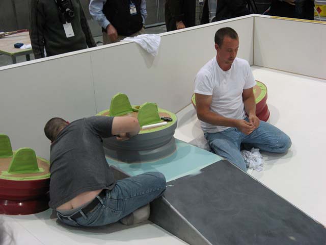

That's correct Lars. Here's a pic of that triple IPS mold insert during the fairing process...

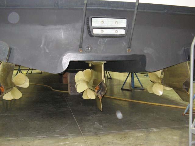

And here's a pic of the triple-IPS installation...

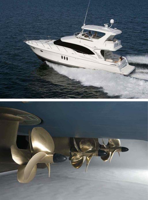

Posts: 214
Marquis has the 50 Sport Coupe with Triple IPS as well as the Tiara 58 Sovran. Both with Triple Volvo IPS 600 435hp per engine but with the IPS drives they say it is equivalent to a shaft drive 600hp engine.

I forgot the Silverton Ovation 52 has triple IPS drives as well.

Just a quick aside but if you look at the photo of the triple IPS installation shown above, those transom anodes from Volvo are Aluminum and not Zinc.
They crumble like hell, Volvo have modified them but why not just make them in Zinc?
