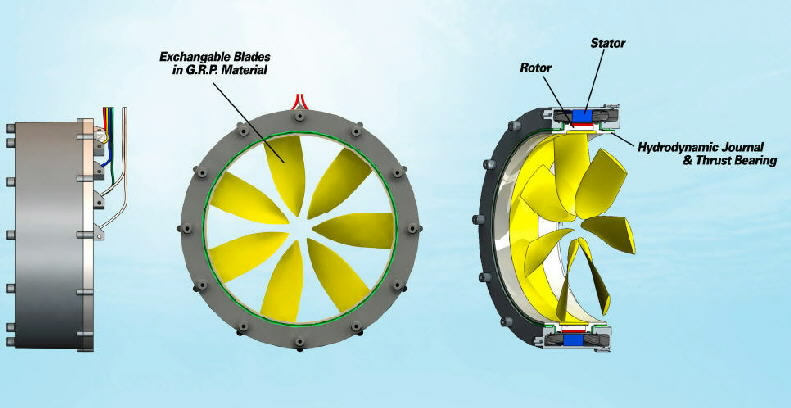

Posts: 644
RimDrive view
Extracted this view of a rim drive unit from a document recently sent to me
brian eiland is offline   Reply With Quote

Perhaps someone can clear up a question that keeps coming back for me.
Perimeter driven props being more efficient makes perfect sense to me.
However, having sharp ended blades unconnected in the centre has me scratching my head. Wouldn't there be more flex and therefore loss of efficiency as the blades deformed forwards under load? Wouldn't having them connected in the centre make for one solid structure less prone to flex and fatigue?
Codger is offline   Reply With Quote
Old 09-02-2007, 03:26 AM   #23
First Pericles
Registered User
Join Date: Aug 2007
Location: London (for now)
Posts: 22
Exchangeable blades. See Brian's post #19.
First Pericles
First Pericles is offline   Reply With Quote
Old 09-02-2007, 09:15 AM   #24
Codger
YF Wisdom Dept.
Join Date: May 2005
Location: Western Canada
Posts: 868
The blades shown in post #15 are connected at the centre so it's being done both ways.
Replaceable blades is a nice feature but is there a tradeoff in overall efficiency by not having them connected at the centre?
Old 09-02-2007, 11:25 AM   #25
Castlerock
Senior Member
Castlerock's Avatar
Join Date: Aug 2006
Location: New England
Posts: 225
I think that having the added strength of the center hub would reduse blade flex and pitch change. Then again if you could calculate the load and flex you could design in more pitch. Now if someone would make a composite Pod Drive with this system for yachts I can see it being much lighter that the Schottel and ABB units.
__________________
There is no proof that life is serious.
Castlerock is offline   Reply With Quote

Several advantages
The first thing that popped out is that the blade design can use much less material- less drag. The point of highest velocity/load is at the rim where support is best. The last picture shows a plug connecting the blades- vibration control?
The bearings are interesting too. By using water to generate a hydrodynamic film-the wear component can be less in steady state operation than in start-stop service like a thruster.
The only drawback is the drag caused by the tube/motor.
For commercial displacement use this has lots of promise.
How do you think the drag compares to the IPS design?
