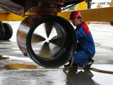

    Lets add some pictures of the Brunvoll test unit.

  9. Ben
    Ben Senior Member
    Feb 9, 2005
    176
    Melbourne Australia
    Can anyone tell me the purpose of the special keel on the bottom of the test boat, and why it doesn't have a normal keel like in the top picture?
  10. nilo
    nilo Senior Member
    Feb 7, 2005
    682
    Istanbul
    i am not an expert on hull designs, but i believe they are trying to monitor the water flow into the propellor. this is very important in regards to the efficiency.

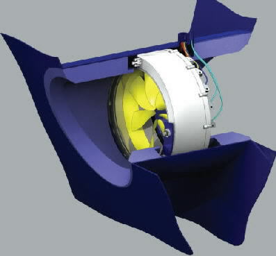

    RimDrive view
    Extracted this view of a rim drive unit from a document recently sent to me
  20. Kruse
    Kruse Member
    Feb 17, 2005
    34
    Denmark
    nice
    I see a lot of potential in these systems:
    - The large diameter of the motor will produce a lot of torque.
    - Potential for max efficiency with the direct drive (no gearing or gearbox).
    - Minimal profile in water, the benefit of ducting (efficiency and build-in rudder function).
    - The rim-mounting of the blades (no center hub) should make them much less sensitive to damage.
    With somewhat flexible blades (less pressure on the blades in the center),
    they could survive chewing on fishing nets, logs, big fish, terrorist divers and pirates etc.;)
    The big question now is longevity, effectiveness, availability, and prize.
    Any risk of a galvanic corrosion problem on metal ships with the Carbon/plastic?
