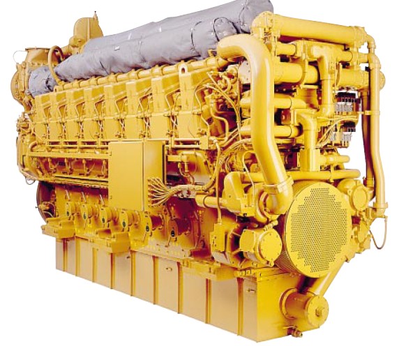

    Never did get around to answering your original question. Cat specs the 3616 at 10- to 12,500 hours for the top end, and 20- to 25,000 hours for the bottom end. My guess is these really "big" diesels run with relatively low BMEP, thereby increasing their longevity.
    Only 3616 deployment I know of is Limitless.
    It's a really big engine!
