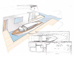

    The hullform for the SABDES 70 is a planing monohull form, though along the way we did develop an original idea for a hull which morphs a monohull with cat-pods aft as seen in attache piccy; the purpose so the float-in-dock would be open all the time without need to flood. The wavepiercer hullform didnt suit the concept ideas correctly, though there is a trimaran hull seen on the NWBS yachts 61m E-motion was considered ok.

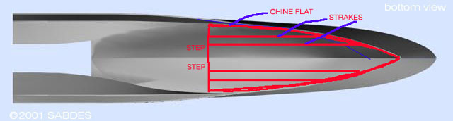

  9. SAB
    SAB New Member
    Jul 7, 2004
    77
    Melbourne, Australia
    Here are a few more renderings of that particular hull, and the original BIC pen concept development sketch. Should be somewhat self explanatory looking at the images; The design idea we termed the 'aqua hull' evolved for the need to have a 'float-in-dock' that allows guest tenders to enter, but without the need to keep flooding and draining the dry dock... also the trim and stability remains the same if it always is open to the water. The morph takes place at the chine underwater, so the hull looks completely like a nomal monohull except from aft. The keel of each pod is off centre (outboard) making the deepest part of the pod as far outboard as possible to also increase stability. Vee sections at the morph point, and a tapering flat run as it goes aft, allow the pods to still provide lift. A trim-tab could be configured to deflect spray away from the dock bay. Tenders could be stored port and starboard and lowered to the centreline of the vessel, this further reducing change of trim, as seen on most Superyachts today where the boats are sent outboard. Hope that explains it more clearly... we dont have all the answers yet, as it was just an idea and we reverted to a more conventional hull for the SABDES 70.. However, when I was a kid I saw a 15' plywood model (in 1982) of a wavepiercer cat in Hobart, with an extended shaft on its Johnson motor so it could reach the water... that was the start of Incat wavepiercers. SABDES

  17. Donald Blount
    Donald Blount New Member
    Sep 22, 2004
    8
    Chesapeake, VA
    Having designed vessels from 42 to 67 meters O A which have been built and sea trialed at speeds substantially above 50 knots, I question the buttock shapes of the monohull portion of the hull as being somewhat non-lifting in the hump and higher speed ranges. The monohull bottom shape is analogous to attempting to making a canoe plane. Negative dynamic hull bottom pressures will be developed beginning near 25 knots which may "pull down" the bow instead of lifting it.
    My advice is to carefully study this hull form with realistic model tests before marketing energy takes control of decisions on committing large financial resources.
  18. SAB
    SAB New Member
    Jul 7, 2004
    77
    Thanks Donald for your review and sound advice. I agree with all your points, particularly that the main hull buttock shapes need refining.
    In the interest of achieving a monohedron hull form, one proposal could be as per the new image I attach; At speeds <20kn the mainhull acts as a displacement hull, but as speeds increase >20kn + the addition of chine flats and running strakes aid lift. At the point where the main hull buttocks begin to curve upward, the chine flats and strakes stop and a step in the hull is added. The aft part of the main hull would lose resistance due to being recessed, and the hullform then becomes a 3 point planing surface, ie: main hull and aft sponsons. Weight distribution woud be critical for the correct trim angle, and the effects of the rooster tail would need careful consideration.
    The SABDES 70 hullform in our later versions reverted back to a standard monohedron form, as can be seen in the attached early concept study image from 3/4 aft. Note the transom seen underwater.
    Marketing wise, the idea for the hull form was not so much to reinvent the wheel while achieving high speeds, but an attempt to find a solution to create a hull form allowing the 'float-in-dock' without the need for constant flooding and draining. (as seen for eg on Princess Mariana, and some Naval Vessels). I came from a Naval design background, which was my inspiration in developing ideas for a 'float-in-dock' for tender deployment on Superyachts.

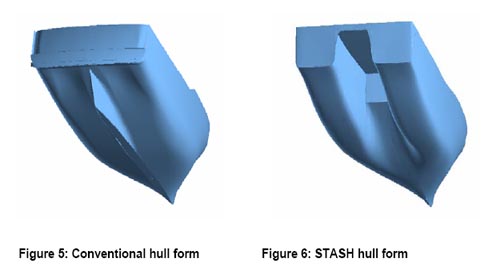

  19. SAB
    SAB New Member
    Jul 7, 2004
    77
    AMELS - The STASH concept
    Amels have been producing a design where they split the Monohull aft into a Catamaran. They call it 'the STASH concept' (Single to Twin Aft Ship Hull).
    Their basic idea is again to create an inside harbour for large tenders. Benefits are the tenders are located at the centreline, and the dock does not have the need to flood. The STASH was developed over a period of one year by the Amels Design Department with special contribution by Dirk Degroote, and was presented at 'Project 2004' Amsterdam Nov 2004.
