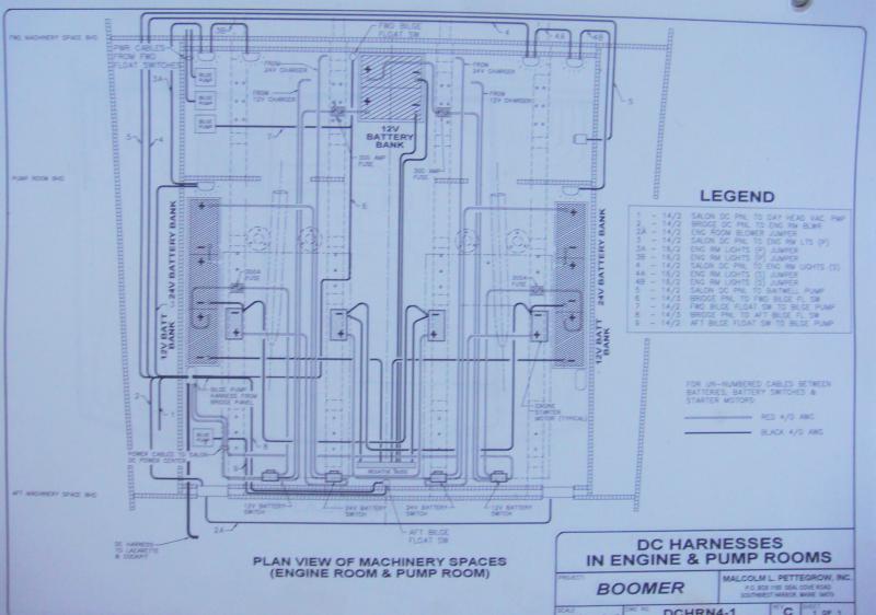

Love these engines too.. Balanced blueprinted, and numbered by Penski.. Friend of Ben Gannett, who had this boat custom built... SO, they tell me....
My house and 12 volt engine DDEC batteries are charged by the 12 volt constavolt.. 4 batts in 3 banks of 2,(actueal house).. and 1 port engine. and 1 stdb engine..
My 24v charges the 2 8D banks of 2ea in series..(total 4). And each side is connected to the battery load equalizers for the DDEC system along w/ the 12v engine batteries.......

AHh... The engines both have (2 ea) starters that draw off both sets of 24 volt batts they tell me in the DDEC manual... Also I can hear it draw the engine down (usually Port) when I try to start the stdb, unless I have a full, and I mean FULL charge to the stdb batts.. EVEN though the main ING box has port and stbd selector switches....
My problem, is the constavolt now charges the heck out of each of the 2ea/12 series in a short amount of time , running my digital displays up to 32 volts in about 1 minute... I turn it off and it drops down to 25 volts.. Still usually does not crank the stdb engine unless I let it charge for about 3-4 minutes and crank it w/ the constavolt powered up...

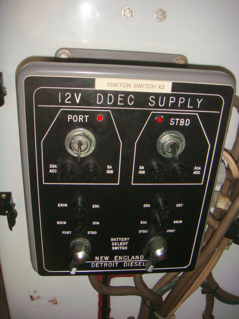

Are you certain your 12v supply to the DDEC comes off your house batteries? On my 12v92 DDECs I have 24v starting batteries and alternators and the DDECs get 12v by pulling off of one of the 8d batteries tht are in series for starting. The problem with this set up is it draws one battery down and overcharges the other. I get voltage spikes of over 32 volts when this happens due to unbalanced batteries and weird loads on the alternators. In my system I sometimes get a low voltage alarm on my DDEC and put a meter on the two 8ds and find one at 11v and the other at 16v.
I'm in the process of installing dedicated 12v batteries for the DDECs to get them off the 24v bank. I've ordered a 24 input, 12v output battery to battery charger so I can stil charge all the batteries from my 24v alternators. This will allow my 24v banks to stay balanced and equalized.
Your problem sounds similiar to what I've experienced. And if you are getting your 12v supply from the house bank I would change that. The DDEcs use a lot of power as the injectors are 12v. My 12v92s use upwards of 35 amps, so your 16s are gonna use even more.
