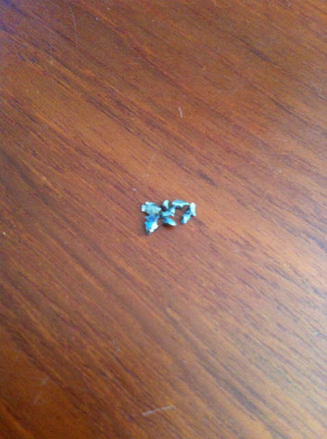

I have just repaired the port Allison Gearbox, so I was checking the starboard gearbox oil and found the oil was aerated.
Then checked the screen/filter and the hose to see if it may be sucking in air and found metal filing behind the screen.
After the panic had settled I had a good look at the filings. This could be wishful thinking but they may be from left over drill filings. They certainly look like it.
Maybe the person who replaced the rear engine seal drilled the metal part of the seal to remove it and left some drill waste to get sucked into the screen? The filings look similar to the ones I carefully cleaned out of the port side when I had to use a drill to break the old seal.
