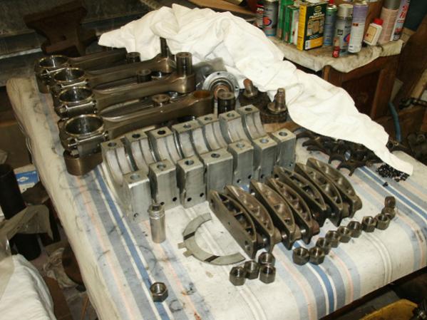

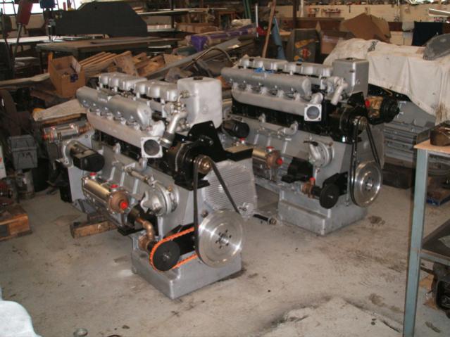

  14. david_japp
    david_japp Senior Member
    Feb 7, 2005
    369
    london
    some pics of my new Gardner 6LXB engines being rebuilt
  15. dennismc
    dennismc Senior Member
    Jan 29, 2009
    1,179
    Vancouver BC
    Rebuilds
    WOW !!! look at those long stroke con rods,,,yummy...
