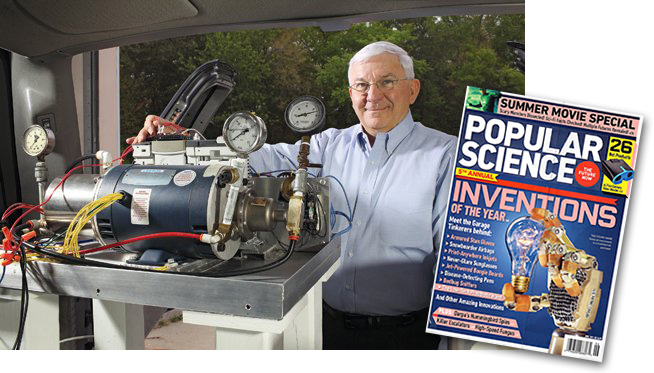

    I was cruising thru a June issue of Popular Science and ran across an award that had been given to this potential onboard sewage treatment device. I thought it definitely deserved some discussion on these forums.
    "What if we could eliminate sewage? The ZLD virtually does just that! It takes the sewage (solids and liquids), grinds them up and homogenizes the solids in the liquid.
    The ZLD then takes that liquid (that looks like chocolate milk) and pressurizes it and sprays this liquid into the hot exhaust gas of the engine. The hot engine gas vaporizes the liquid, and kills the bacteria and basically eliminates the sewage with no odor no liquid or no sludge to handle."
    I went looking for a website and found this,
    Zero Liquid Discharge (ZLD) Sewage Elimination System

    I don't see where he is dumping into the 'machinery', (or boiler as you might have experienced). It appears as it is dumped into the exhaust at very near the exit point?
    ...and it appears as though it has received a US Coast Guard Certification
    http://www.thezld.com/index.php/project-profiles
