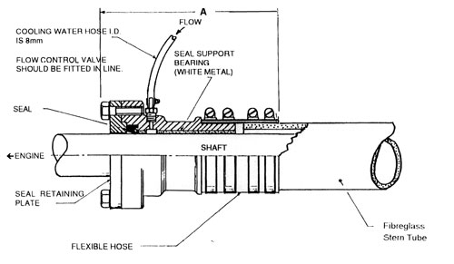

Quote:
Originally Posted by K1W1
I don't see any reference to a bearing within the seal assy.
Here is a drawing that purports to be the Chatfield "Bluewater" seal assembly.
http://www.southernseasmarine.com/ss...ms/bw_seal.htm

Quote:
Originally Posted by CSkipR
K1W1
I do have the Chatfield Shaft seal on the boat except mine is not the commercial one. I believe the one you are showing is the commercial one and my is the standard. go to www.chatfieldmarine.com, driveline, shaft seal, standard. Any comments are welcome.
I figured you might not have the commercial one which is why I wrote It's a pity you don't have one of these before posting the link.
Marmot, You got a better cross section of the seal assy than I found on their website, I must say the www conn on my IPhone isn't very good from the bottom of a 8000 gal black water tank or I would have replied sooner :-).
I than I found on their website ...
It isn't your iPhone, Chatfield doesn't provide that drawing on its website. That is why the link goes to another supplier.
The cynical Marmot believes the manufacturer doesn't really want anyone to know what the weak points are.

CSKIPR- If you go the Chatfield Marine website there is a place where you can make an online enquiry.
There is also a phone number that you can call if you can get your timing right.
I think that at the moment if you are GMT -5 in Florida at 1700 local time it will be will be around 1000 the next morning in NZ as NZ is GMT + 12 at the moment.
This means you could call them this afternoon and might find someone there on a Saturday morning.
It looks in that drawing that Marmot found that the white metal brg is only used to hold the seal in a straight line with the shaft, Marmots suggestion that it may be goosed at the ends is a pretty valid one given how it is actually constructed.
