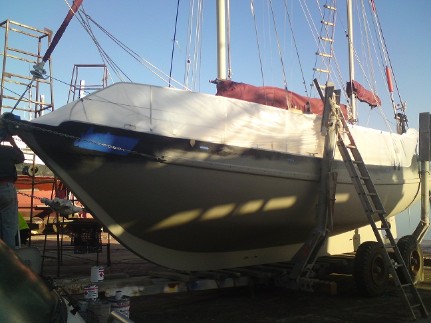

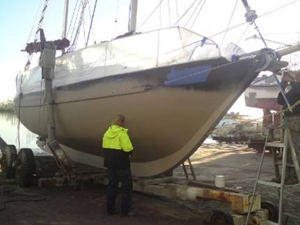

Unhappy Steel Boat Application
Ran across this unhappy application
Quote:
Originally Posted by brian eiland View Post
http://www.astrayspray.com/our-story...-we-have-left-
"We hadn't physically left! We had to re-sandblast the hull and recoat with conventional anti-fouling as the Sani-tred stuff just didnt want to stick!"
http://www.astrayspray.com/the-hull.php
"We used paint from USA, shipped here at great cost - more than the paint itself, but hopefully worth it. We have been told by the company that as long as we apply it to their specifications, they will guarantee the product for the life of the vessel. So we painted it on as specified. The first coat of grey Permaflex was applied in a little over a couple of hours and then when it was touch dry, about 3 hours later, the second coat was applied."
http://www.astrayspray.com/hull-maintenance.php
"OCTOBER 2010
At the end of this month, it will be Astray's 1st birthday from launching. In that time we have had to slip the boat twice because of problems with the paint on the bottom of the hull. Unfortunately the rubber product we bought at great cost from the USA, which was guaranteed to stick and required no anti-fouling, has failed. When we removed it the first time it had extensive growth on the hull and we assumed that it was because of our location, as we were in extremely warm water (up to 40 degrees C at times) which had softened the rubber and allowed the organisms to grow and water to seep between the rubber coating and the hull. We water blasted the hull and the paint peeled off in sheets in most places below the water line but on the keel, in patches, stuck incredibly. The steel underneath was pristine, as if we had just grit blasted it! We contacted the manufacturers and, according to their instructions and specifications, cleaned the hull and recoated. Regretfully after only a few months, it started peeling and did not bond with the previous coating as it should have. Slipped it again with the same result. We have been racking our brains to find a cause, let alone a solution but in the end decided to return to the 'tried and true' method of blasting, and coating. James and Dennis did a great job, it took James 2 days to get all the rubber off! In some places it stuck so well! It was then coated in two layers of primer, a tie coat and then 30 litres of antifoul paint. As you can see in the pictures below, we are now ready to go back into the water and hopefully will not need to slip her for at least another 2 years. Above the water line, no complaints!"
NOTE: I have written the Sani-Tred company an email and asked for an explaintion.
brian eiland is offline   Reply With Quote
Old 05-05-2011, 10:34 AM   #10 (permalink)
Senior Member
brian eiland's Avatar
Join Date: Jul 2004
Location: Washington DC, Annapolis MD, Thailand
Posts: 2,057
I got an answer, and a pretty complete one at that. Here is what I ask of them:
Quote:
I'm interested in your product for both general reasons, and likely a specific application I may have in mind. I come from the boating industry, and I have entered in to several forum discussions referencing your product's application. In one instance today I discover a pretty negative experience someone had with your product in an application onto a steel hull vessel. ...posting #94
Can you explain what may have happened here??
Sani-Tred Technician's Reply
I was able to pull up the customer’s info. The web page/blog you referred me to had the name “Kerry & Claudia South Australia” on it so I searched for those names and cross referenced to that location (Australia).
We show one order for Kerry and that is all.
I was able to find the customer’s email address in our records so I searched our previous correspondence. I found several emails from this customer regarding their application and the source of their problem. They stated that they sand blasted the steel, deliberately let it sit for days to form a powdery rust film then began applying the PermaFlex over top of the powdery rust. THAT is precisely why they had delamination issues over the majority of the hull. Sani-Tred products come with application instructions and the customer deliberately chose to NOT follow them. The customer even specifically asked us about the sand blasting and we sent them a step-by-step tutorial. What they did was follow some other written specification from another company that recommends applying over top of a powdery rust film. Our customer did NOT contact us to ask if this is recommended or what would happen if they prepared their substrate in the manor that they chose (which contradicts with the tutorial and application instructions we supplied.
When we explained to the customer what they did wrong and why they are experiencing this delamination they became very upset. They became bitter, slanderous and their blog is in no way accurate.
Based on what their own blog states, and I quote, “We contacted the manufacturers and, according to their instructions and specifications, cleaned the hull and recoated”. They used the words “manufacturers” meaning plural. They were still in contact with the other company that supplied them with the information regarding the method of preparation that caused their problem to begin with (not us)! We can only assume that this other company supplied them with info regarding HOW to reapply. We have absolutely NO correspondence with our customer regarding any ‘reapplication’. Keep in mind that they only placed ONE order and that order was NOT for twice the amount that they originally needed. In their blog they claim that their ‘reapplication’ delaminated as well. We have never received a single complaint, photo, email, letter or any contact regarding a reapplication.
Just for fun I’ll assume that a ‘reapplication’ was performed. Where did they purchase the materials? What materials did they use? How was the reapplication performed? How did they prepare the substrate for the reapplication? I have a theory about that … and keep in mind that this is just a theory based on what I see in their photos. I bet that they sprayed the PermaFlex on the hull for their original application. Notice how the boat was masked in the photos in the blog. They used sheet plastic and it appears to have been sprayed. I do not see any brush or roller marks, I just see overspray
If they sprayed the PermaFlex, it is highly likely that they sprayed ‘airless’. We spray ‘air assist’ and have abandoned spraying airless many years ago. When spraying PermaFlex using most common airless units it is typically necessary to thin the PermaFlex to a very low viscosity or you cannot obtain a spray pattern. When any material is of very low viscosity that material WILL lack vertical cling. In other words the material will be very runny and lose its ability to be applied at the proper rate to a vertical or inverted surface in a single application. Additional coats MUST be applied in order to compensate for the lack of vertical cling. If this is in fact the case then this is another mistake they made during the application and by spraying PermaFlex in this manor it would stand to reason that they would have lots of PermaFlex leftover (by being applied way too thin and not at the proper rate/thickness) in order to have enough material on hand for a reapplication. If they reapplied by spraying it in the same manner as the first time then this could very well explain the problem they had with their alleged ‘reapplication’.
If a customer does not call and ask questions before the application and assumes something other than what the application instructions state to do will work, we cannot assume responsibility for what he does and how the application turns out.
