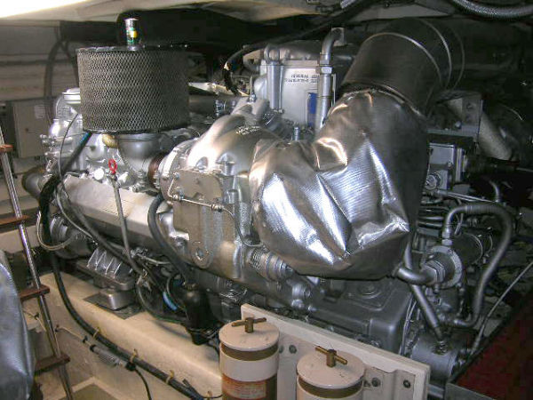

here is a picture of my port side engine with the filters on the lower right, not a very good picture but I need to check and find the gauges
