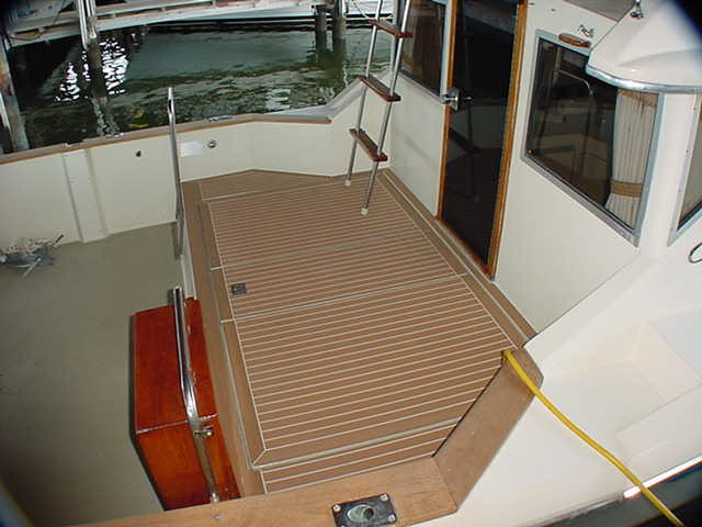

I have Flexiteek 45mm white on my 31 Chris Craft engine hatch deck area. I'm quite happy with the results and I think it looks great with my existing teak covering boards. It cost around $75/sq ft installed. It does get warm in the sun, but not too warm to walk on in bare feet. Curiously enough, the original Chris Craft dark beige color on the lower aft deck area does get too hot to walk on.

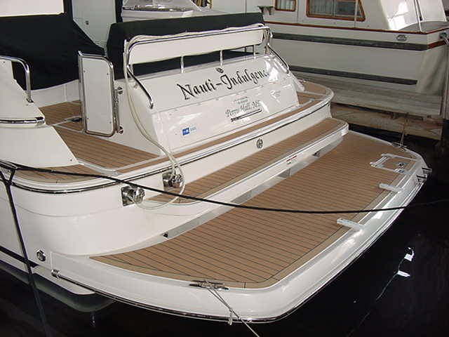

Your thoughts on fake teak are certainly valid. However, I think the Flexiteek is an improvement over non-skid. It sure changes the look of this Regal 4460. For most owner maintained boats, Flexiteek is a good choice.
