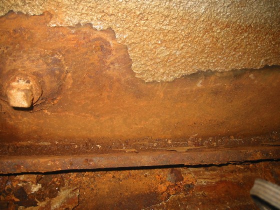

- How was the botom of the V inside the hull was the tar pealing off until how high from the begining of the V.

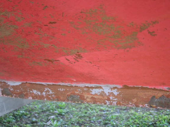

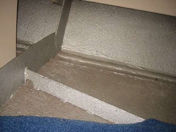

- My interior look very clean pic 1866 except at the bottom of the V.
Hull sections
- Which parts of the hull needed replating?

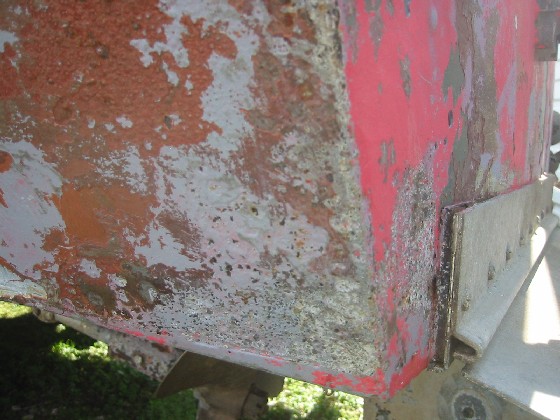

- The part I have doubt on are the side panels at the 2 rear corners(see pics 1916&1921)
- the bottom of the V looks very solid from the outside (see Pic 1927).

- What did you do inside in the Bottom fo the V? did you apply the bitumen? did you just paint with a protecting system?

Prior to the sandblasting the Hull looked decent, we decided to sandblast the boat b/c we just purchased it a year prior and were not sure what really was under all the bottom ‘paint’ - in short it was for peace of mind. We definitely did not expect the hull to be in as poor of shape as we thought it was, but it fairness this is our first steel boat and really had nothing to compare to. Our welder said it was in great shape for a boat of her age and that we did a very smart thing by stripping it down and plating as needed, and then some…therefore I would say some of the plating was very obvious i.e. holes that had gone right through the hull, and in other areas there was evidence of electrolysis (pin holes) which we plated as well, again for peace of mind. The rear corners on our boat were in good shape; after sandblasting it was obvious that someone had previously plated the port stern portion (not actually on the stern, but on the port side of the boat, below the waterline towards the stern).
As far as the inside goes, it was generally in great shape, except along the V as the previous owner had let water sit in throughout the winter. We cleaned it out thoroughly and painted all the areas with Petits Rustloc, including all areas that were welded on the outside – this is a must as the welding will burn the paint off on the inside and leave raw/exposed steel – not good!
