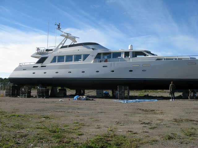

  11. AMG
    5,392
    K1W1, i took these pictures of United Spirit two weeks ago. One of her KaMeWA jets was not in place, but otherwise she looked OK. This foam was added almost 20 years ago and I have just seen a minor crack about five years ago. It is pretty easy to repair from outside.
    This boat was built in 1939 in 5 mm aluminium plates with rivets. The idea with applying foam outside on new constructions was to use robots for both the final shape and fairing. This shipyard have two ABB robots installed, but have not used them for this application. On older boats it is more man-hours, but not many more than putting tons of filler to sand down.
