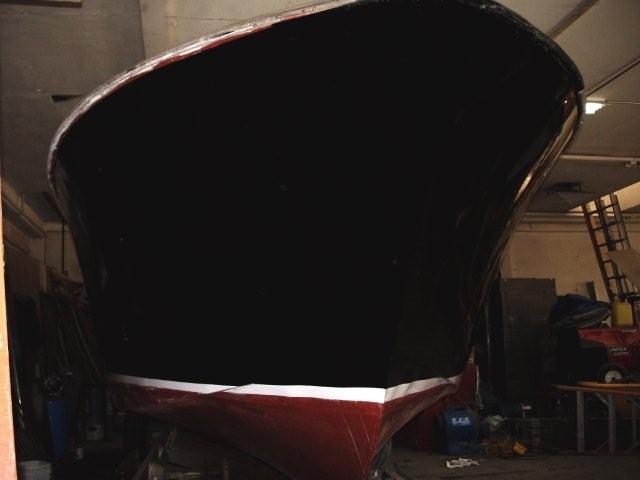

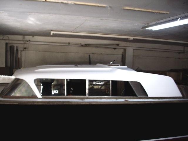

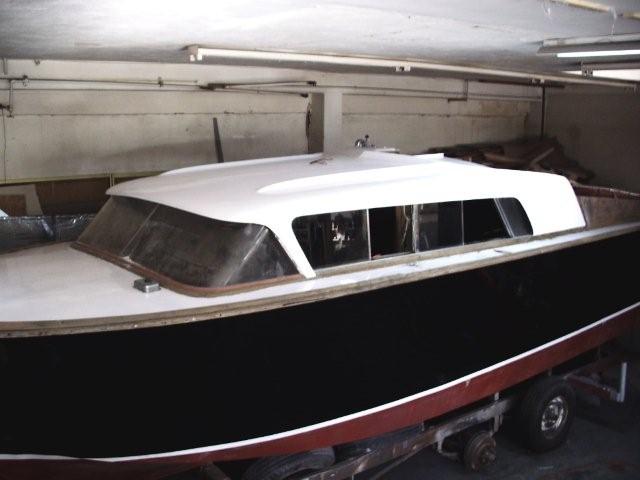

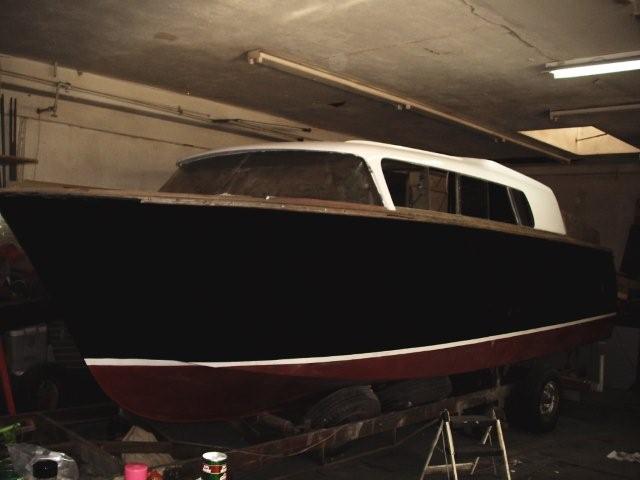

    have replaced 20m2 of the botton of our boat shall put some pic of my project so you can see how to do it the right way
    bestregards Erik

  5. Oneiros
    Oneiros Member
    Dec 17, 2006
    299
    Hi Yes that the way you should do it we veld first on the inside then on the outside.Im gong to put in some pic from my job so you can see more my english is not so good.
