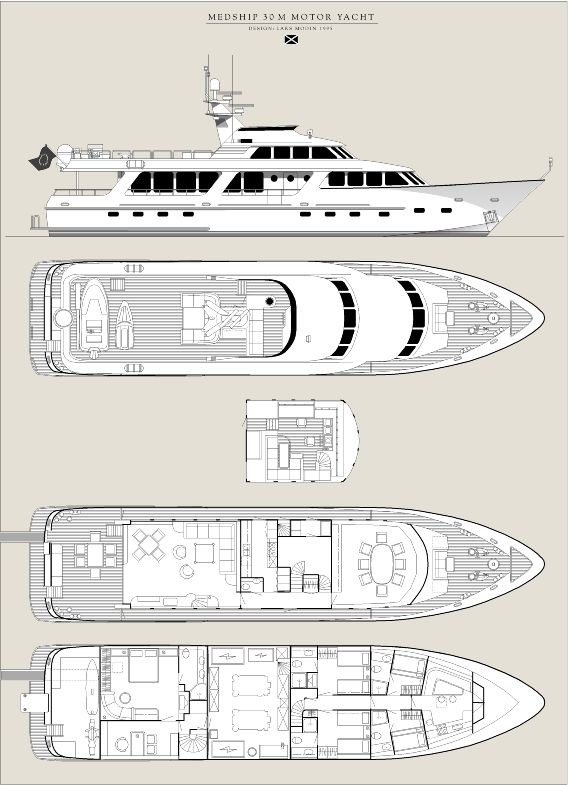

Got one from Lars
Some time ago I was playing around with Lars on a 30M cat.
I think he will not object to me showing it here.
It fits my description above (of course)
The name "Kite Cat" stems from the idea to have a kite as traction-power for passages with the (trade)winds.

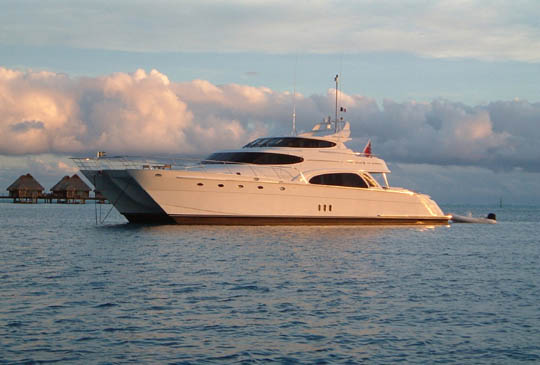

Before we get too far ahead on this subject, careful consideration must be given to the market. It's not enough to propose and design a new build, but securing resources, such as funding and an experienced yard are an important part of the equation as well.
Case in point... there is an experienced builder that has produced a yacht possessing many of the attributes previously stipulated. John Winter's "Pacific Harmony" for example is a catamaran that meets many of the protocals set forth. Launched over a year ago, they have yet to find a buyer for this boat, yet it has been continously promoted by brokers in various publications. (there is a YachtForums feature story on it as well).
Possibly there is a lack of acceptance in the "yacht-end" of the market, because few yacht builders are producing catamarans. This would in-turn, impact the popularity and education of the market. The only logical reason I can conjure up as to why Pacific Harmony has NOT been sold by now... would be "price-point". In this price range, there are *many* other yachts to choose from, offering pedigree and luxurious accommodations, which are very important factors to new buyers.
I've been onboard Pacific Harmony and it is truly an outstanding yacht. We would be hard pressed, collectively, to do a better job. Just something to think about...

Already in mid of 2003 i got the price of 4.5 Million Dollar US (5 % Broker fee included ) and now 1.5 years later you have to pay 4.95 ???

How about this??
In this month's Boat International I noticed "Pacific Harmony" built by Winter yachts in NZ, listed by C&N.
Fraser Yachts shows an identic cat "Seaquest" built by Pachoud - NZ.

Check out the design at my web site (some of it is still under construction) at http://www.amb.iinet.net.au - note: follow the SMDG link on the left side and view the Montego 102.

Stephen,
Montego 102 Design looks great

YachtForums Dreamyacht 2005..?
The perfect yacht is maybe impossible to get as we have all different ideas on how to use it, but we could call it the YachtForums Dreamyacht 2005?
Anyway, I have been looking through the initial ideas and digged deep into my files trying to find something to go from. To start with I think we should not look for too inventive ideas, as they always take much longer to get acceptance for. My approach is rather to use what we have learned during decades of yachting, what is important, what is working and what is not.
My first entry is a yacht I designed in the mid 90:s after having lived onboard a Moonen 85 for a couple of years. This yacht is a little larger and have all the things I found could be improved on the Moonen. She is 100 feet but can still be owner operated if you like. But with two crew cabins and a crew mess, the choice is open and allows for charter as well. The owners cabin has here got an optional office and the two main guest cabins could have one bed movable to arrange a double bed. There is also a foldable bunkbed in each.
The raised wheelhouse has a dinette and observation area and above is a fully fitted flybridge. The boat deck has a dining area that converts as a sunbed and there is a pantry with barbeque.
The main deck has a formal dining room, a galley in the gravity center, and a large salon with a smaller breakfast and game table. Aft deck has another table and there is one for the crew on fore deck as well. I have a total specification, but stop here with saying this yacht has an economical cruising speed of 9-10 knots with a transatlantic range.
Well, no big surprise, but in my opinion this is the perfect entry level for people looking for a dreamyacht with superyacht quality and I think that many would think twice before going up in size.
This size of long range yachts was built by many shipyards before, but not today and I think this is a good opportunity to explore what can be done in Taiwan and mainland China who are now venturing into yacht construction.

Lars,
There are many design features about the 30m Medship that I find personally appealing...
1. Full walk around main deck. (makes docking easy)
2. Full size windows in the salon & dining areas for unobstructed views.
3. Full size enclosed bridge, with a 360 degree view (assuming windows are aft)
4. A large upper aft deck for tender storage, that doubles as a party deck.
5. A bow with abundant freeboard.
It's difficult to discern, but the galley looks like it might be closed-off by a wall to the salon. If this wall was lowered to become a counter-top, it would create more of an open floor plan, which adds size to the interior and and creates a interactive ambiance.
The Med 30 has a very functional lay-out with time proven design elements. A nice boat indeed!
