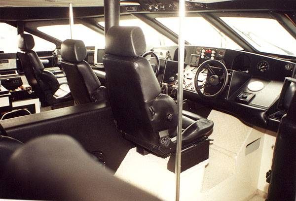

  6. Donald Blount
    Donald Blount New Member
    Sep 22, 2004
    8
    Chesapeake, VA
    Destriero
    What more do you know about Destriero?

  9. Donald Blount
    Sep 22, 2004
    8
    Chesapeake, VA
    Destriero was only operated under charter by the Yacht Club Costa Smeralda. The vessel is owned by Bravo Romeo Limited.
