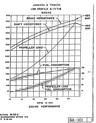

Ruby,
btw, you may have this graph already, it was in my post owners book.
if you dont have it, this gives you a pretty good idea of your fuel burn on the 671 TIB.
regards,
RT46
RT46 is offline   Reply With Quote

Posts: 51
Thanks for the power graph, that is one thing that I have to look into getting. I unfortunately did not receive any owners manual or electrical diagrams from Post. The person I bought the boat from never had it.
ruby is offline   Reply With Quote
