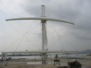

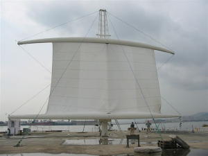

Setting sail etc
Setting a sail on the test rig
