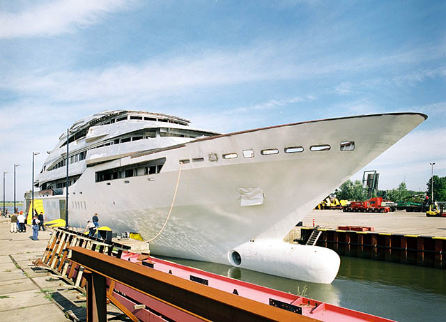

    Y701 in lock, preparing to be lifted out of the water. Notice how bouyant the basic hull and superstructure is. For the bulb to be completely exposed, it gives you an example of how much work is yet to come AND how much equipment is yet to be added...

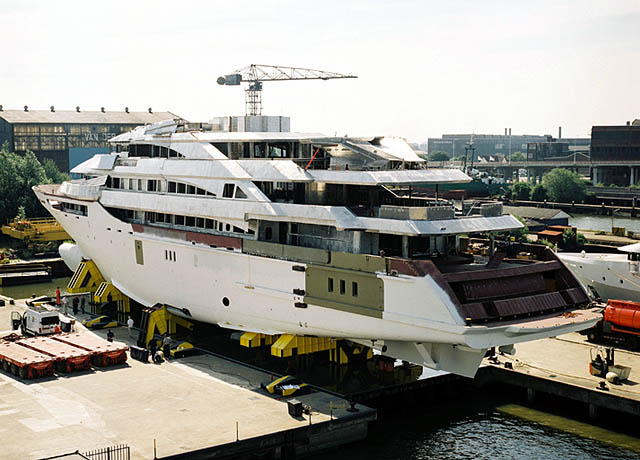

    Y701 is set and lifted onto cradles by Mammoet, a very qualified team of technicians. Here you can see the shafts, props, rudders and stabilizers are not installed yet. Also note, the side load tender garage (in green primer) to maximize deck space...

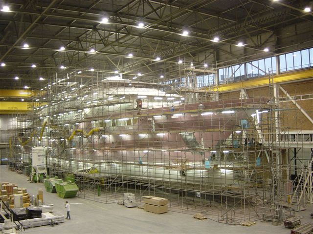

    August 29th, 2005...

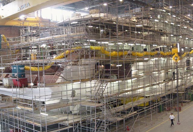

    Completely skinned in scaffolding, the Y701 will stay cocooned for several months while further finishing continues. Eight levels of scaffolding are constructed, complete with staircases located at the stern, midship and bow. Every level of scaffolding is illuminated with flourescent lights, in addition to ventilation systems that snake throughout the interior.

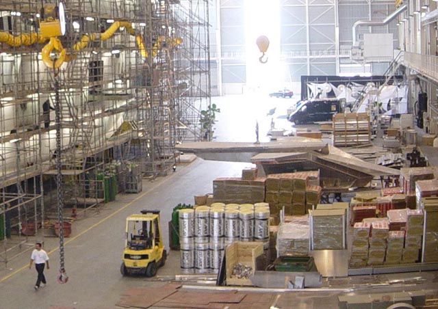

    20,956

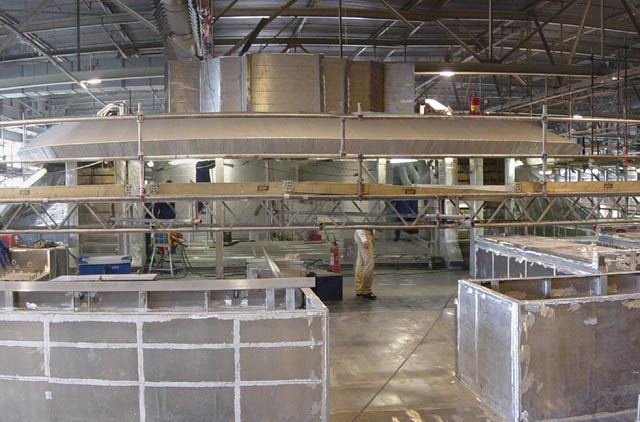

    Building supplies for each stage of completion are shipped in and stored adjacent to the hull on the shed floor, where they can be lifted by overhead cranes and delivered to any level of the structure. The structure protruding out amid the supplies is Y701's radar arch.

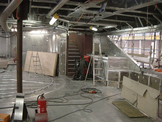

    Moving one deck below, this is the Upper Deck Dining area. When finished, it will feature a cylindrical glass room that will offer a 180 degree view astern. In addition, this level has the largest covered aft deck area on Y701, which will likely provide exterior seating and entertainment areas.

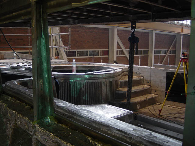

    This is the whirlpool located to the portside of the master suite. Without GA's, it's hard to determine the exact position, but as more images arrive we should be able to better determine its location. Until then... :)
