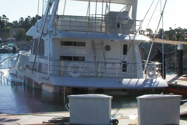

    Thanks for the info..not sure if anyone heard..Hull number 2 sank at a marina in Cabo 10 days ago. Apparently they had tuna tubes installed a few days prior...appears to have been the issue. Very sad............

    Ya i heard about that too. I found a few pics of it a couple days ago but i can't seem to find anymore information on it anywhere. IF you find any articles on it, post them in the thread.

    The preliminary report points toward a defective installation of a 2" thru hull fitting and piping supplying a set of tuna tubes. She was in the yard just before she sank. I'm sure a formal report will be issued at a later date.

    You guys are assuming from hear say that the NH 75 are POS boats. The boat sank because some goof ball in the yard didn't install the tuna tubes correctly and somebody didn't check the installation. Don't you think you should sit on your hands and obstain until there is actual proof before you conclude it is a manufactures defect?

    I live near the marina, in San Jose Del Cabo, where the N75 sank, and have seen detailed photos from inside the engine room.
    The quick story is that a few days prior to the sinking the boat had tuna tubes installed by a local shipyard. A new 2" thru-hull was cut, and connected to a pump with sanitation hose. The hose had a PVC fitting at the end that was screwed into the top of the pump, which popped up in the middle of the night. This resulted in something like 200 gpm of water coming into the engine room.
    I should point out that Nordhavn had nothing to do with any of this.
    The boat does have small electric pumps, but they are rated at only about 11 gpm. I don't know whether there was one or two pumps in the engine room. In any event it is irrelevant. There is also a large hydraulic pump (10,000 gph), but it would have required someone to start the engines.
    The boat was on a side-tie and there may not have been other boats close enough to have heard the alarm. My guess is that the alarm sounded and no one heard, or no one responded.
    The boat has now been refloated and is sitting at the shipyard at the marina. It looks undamaged from the exterior, although I'd imagine the interior is a mess. They were in the process of cleaning up the mess when I saw the boat. The word on the docks was that the boat would be repaired.

    Nordhavn may have had nothing to do with the thru hull tuna tube installation. But I'd expect much more in the way of an automatic bilge pump system then that. Only one or maybe two 660 gph pumps, in a 75' boat!!
    You can't be serious?
