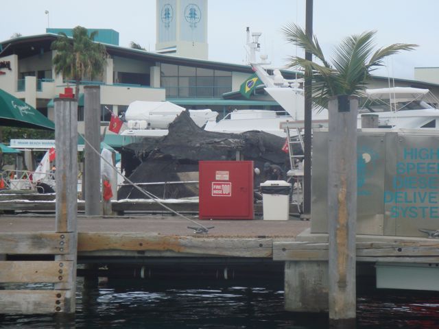

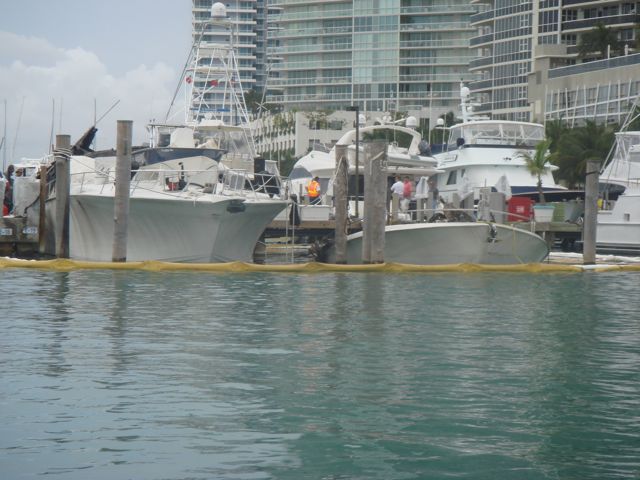

    It's both of them... here is the aftermath:

    Aftermath
    There must be better photos out there. I hope someone has them and will post hi-res formats of them.
