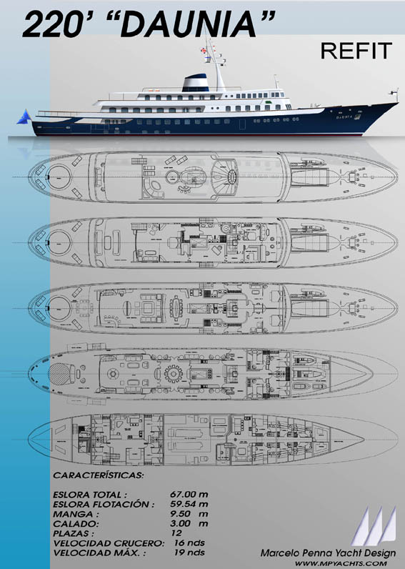

    Most of the newer and larger custom Yachts have a private owner's deck. "Northern Star" is just another of many examples of a suite facing forward.
    This is one of my favorite layouts, Even thought the suite is not forward facing.
