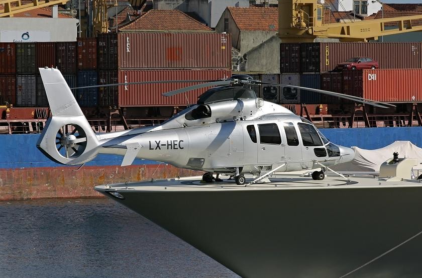

    This is a thread on Delta Marine's 164' Expedition Yacht "TRITON", which you can use as reference.
    Triton has an EC130 copter:
    * Max Weight : 5,291lb
    * Capacity : 1 Pilot + 6/7 Passengers
    * Power Plant : 1 Turbomeca ARRIEL 2B1
    * Fast Cruise Speed : 235km/hr-127kts
    http://www.yachtforums.com/forums/delta-yacht/3477-review-deltas-164-expedition-triton.html?highlight=triton
    I assume similar gross-weight helicopters from other manufacturers can be used (for ex. AgustaWestland, BellTextron).

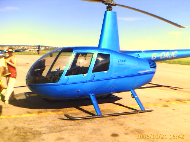

  6. foundrycourt
    foundrycourt New Member
    Apr 25, 2005
    80
    At my desk
    Yeah, I remember that, it was a robinson R22 or R44.
