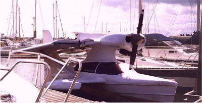

    Having operated a Cessna 206 and then 208 Caravan from a yacht for many years all over the world the advantages are clear. 2 tonne payload, 140 knots cruise and 900 mile range come in pretty handy.
    On the other hand I cannot deny that the MD900 I am currently involved with is perfect for short trips for arrivals and departures.
    You could put a 208 and say a R44 on a 70m yacht. Wingspan of a 208 is 57 feet but it doesn't matter that the wings protrude beyond the yachts beam so a 12m yacht beam is OK . Draft would be 4 to 4.5 metres depending on how much MGO you want to carry.

    I honestly don't think a seaplane is the answer. Yes, it's faster and you can cruise hands-off, BUT... the limitations far outweigh the range and speed. A heli is the only dinghy that makes sense....
    With a seaplane, you are limited in both take-off and landing conditions. You also have the difficulty in loading/unloading the plane from the deck. Adding to this... trying to unload a pilot or passengers from a seaplane to a yacht will most likely result in someone getting wet. The wings are slightly wider than the pontoons. ;)
    I have to admit, my only experience with a seaplane is limited to a Buccaneer Ultralight with floats... quite possibly the best bang for the buck in aviation history and a heck of a lot of fun to fly low & slow. A heli on the other hand offers much greater convenience, at the cost of speed and range. My only concern with a heli is its exposure to a demanding environment. I kept my R-22 inside a hangar. Typically, you don't have that luxury on a yacht, but of all the places... this is where it's needed the most. Offshore conditions are far more severe than those found onshore... even 100 yards inshore. Salt and sun will take it's toll on any machine, whether it be car, boat or plane. With a heli, you've got lots of exposed moving parts, specifically unprotected steel and alloy components, that are critical links. However, with diligent maintenance, none of this is a concern.
    Getting back your question... "seaplane or heli"... in my mind (what's left of it after 45 years)... a helicopter is the only logical solution. However, if you really need an S-61... I suggest purchasing a surplass aircraft carrier! :D All joking aside, the S-61 is among the most proven and capable helicopters in the world. It's absolutely astonishing, given it's size and weight, it's capable of rolling (due to a rigid rotor head). VERY few heli's can do this, such as the Bolkow 105 and select others.
    You don't need to choose a heli the size of an S-61 for amphibean capabilities. There are floats available (or pop-outs if needed) for any machine. Yes, they will hinder your cruise speed, but they truly expand the usefulness of the machine. Just be prepared to swing when you spool-up. ;)
    Let us know what you decide on. Post a picture, or take us for a spin. YF rules. :D

    Yup. I wus thinking a chopper is much more practical myself. I would guess that the one solid advantage of the seaplane is range. But even that would only come into play in really remote territory. Back in civilization the chopper could make the same trip with a refuelling stop?

    Thanks Yacht Forums. I have been rethinking the use of a heli hanger or rather a garage after doing some more reading. I think being able to stow it inside will be the best as it will be going with the boat.I think that is the best way to make use of it. ;) I do like the S-61, the size and that it has no pontoons. I have had some trouble, or not been looking real hard yet, for float kits. The other thing with the S-61 is You can get them as surpluss, as they are being decomishioned now. The other thought was an Mi-14 Haz:rolleyes: The Russian design is nice. What ever heilicopter that I use needs to be able to work in hard enviornments and not be to high maintanance.
    As for the Seaplane maybe a pipe dream, but I would take that. That Yacht might be a ways off. As for getting wet that really depends on where you are getting off. Most operations as said are in harbor or calm water. Some nice south Sea unspoiled place, or for an Eco-friendly resort.
