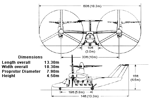

    You might want to take a look at AgustaWestland's BA609 Tilt-Rotor Aircraft.
    Max take Off 7631 kg 16800 lb
    Max Useful Load 2500 kg 5512 lb
    Engine Rating (2 x Pratt & Whitney PT6C-67A)
    Crew - Pilot / Passengers 2 / 9
    Length : Overall - 13.30 m
    Width : Overall - 18.30 m
    Height : 4.50 m
    This seems to be "lighter" than an S-61/SH-3, which has a max take off wt. of approx. 9700 kg.
    You definitely need a "large" yacht to support either aircraft's weight.
