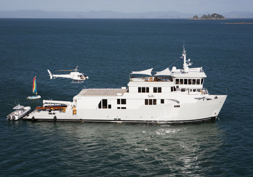

    This is a thread on Delta Marine's 164' Expedition Yacht "TRITON", which you can use as reference.
    Triton has an EC130 copter:
    * Max Weight : 5,291lb
    * Capacity : 1 Pilot + 6/7 Passengers
    * Power Plant : 1 Turbomeca ARRIEL 2B1
    * Fast Cruise Speed : 235km/hr-127kts
    http://www.yachtforums.com/forums/delta-yacht/3477-review-deltas-164-expedition-triton.html?highlight=triton
    I assume similar gross-weight helicopters from other manufacturers can be used (for ex. AgustaWestland, BellTextron).
    Another one is Schweer's 194' "SENSES" also has a helipad, and her specs states: "Helicopter facilities certified to a maximum of 2.5 tonnes."
    http://www.yachtforums.com/forums/new-custom-classic-unique-yacht/161-schweers-yachts-senses-59m.html?highlight=senses
    The above are just examples, and I remember one superyacht that had a Sikorsky on it's helipad (not sure about the model, though).

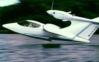

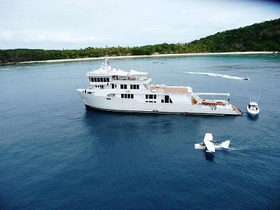

    Having operated a Cessna 206 and then 208 Caravan from a yacht for many years all over the world the advantages are clear. 2 tonne payload, 140 knots cruise and 900 mile range come in pretty handy.
    On the other hand I cannot deny that the MD900 I am currently involved with is perfect for short trips for arrivals and departures.
    You could put a 208 and say a R44 on a 70m yacht. Wingspan of a 208 is 57 feet but it doesn't matter that the wings protrude beyond the yachts beam so a 12m yacht beam is OK . Draft would be 4 to 4.5 metres depending on how much MGO you want to carry.
