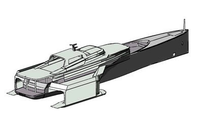

    Carl your right White Rabbit is definitely not a wave-piercer - I don't know what I was thinking.
    The aft hull shape is similar to the photo you showed of the trailerable boat in the wave-piercer thread.
    This reminded me of the aft section of White Rabbit. Although the centre hull of the Tri' is much deeper.

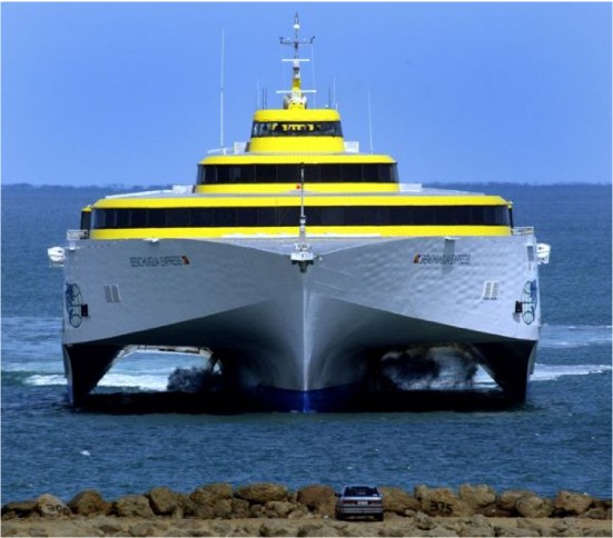

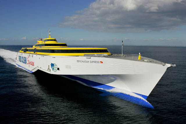

    While we're on the subject of Tri's check out the latest Austal Tri Ferries.
    http://www.austal.com/datasheets/ae127-H260-Trimaran.pdf

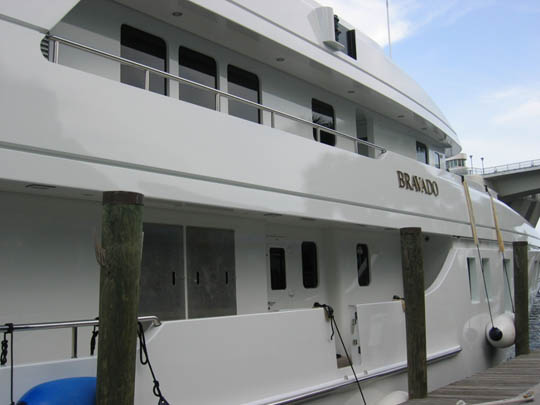

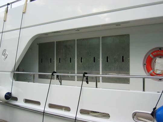

    I've been offshore in big swells, running along the side of other yachts in the 100'+ range and I've seen the dips firsthand, both on our boat and theirs. In the Lady Lola picture above, the swell in the foreground is basically hiding the bow, BUT... she IS at a bow negative angle in relation to the horizon. Also notice the release of displaced water to her stern.
    It appears to me she was coming off the back side of a swell and the following swell was about to give lift to the bow... just before this picture was taken. The spray off the bow in this picture shows she was beginning to displace the oncoming wave.
    This picture is not unusual in offshore conditions, but the angle taken (from the backside of the swell in the foreground)... IS unusual. You can't believe how BIG it gets offshore. Sometimes a superyacht doesn't feel big enough! Because rogue waves happen... you will sometimes see the forward and/or bridge windows "boarded" up. Usually it's with custom fabricated aluminum plates, but I've actually seen plywood used for this.
