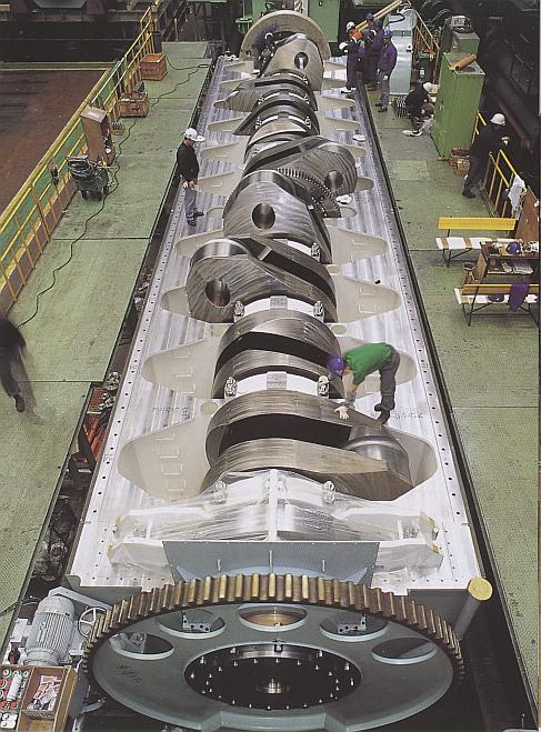

    This is the crankshaft...

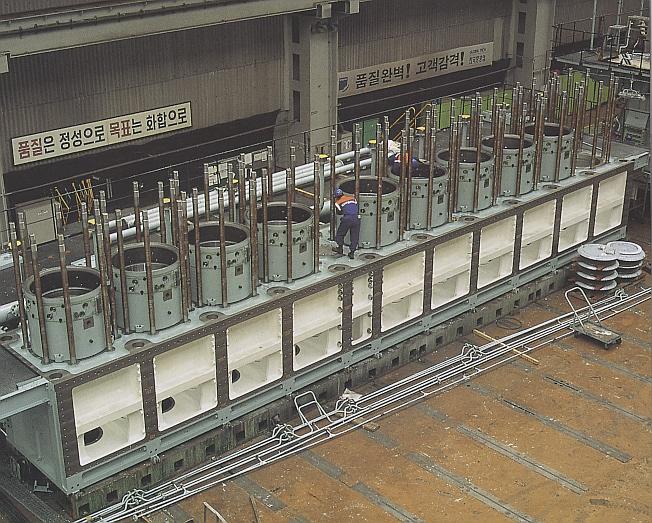

    These are the cylinders...

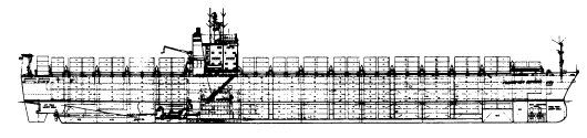

    Here are some more Information about the Frankfurt Express:
    Frankfurt Express built by HDW
    Yard No.168, Owner:Hapag-Lloyd, Port: Hamburg, Country: Germany
    Delivery 1981
    TEU 3.045 TEU
    Measuring 58.385 BRT
    Power 2*20.000 kW
    Length 271,00 m (Lpp)
    Width 32,20 m
    Height 24,00 m
