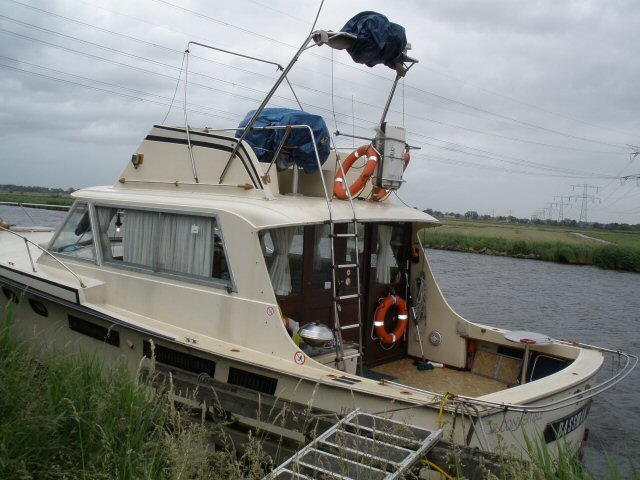

I’m very interested in a Laguna (1973) that’s for sale.
But before I will put a bid on it I want to know if there’s some of you have experience with this type of boat.
The deck it’s a sandwich construction and I found some info about the hull in a ad.
“The hull is a hand laid-up laminate of fiberglass cloth, mat and woven roving, stiffened with longitudinal stringers. FRP sandwich construction is used below the chine from the forefoot back to the water-tight engine compartment bulkhead”
Thanks, Marco

The boat that you talking about it’s the 11.5 metre boat. American Marine build two types, the 10 (33) and the 11.5 (38) metre with the same engine configuration.
What about the rudders? They look to be on the small side for slow cruising.

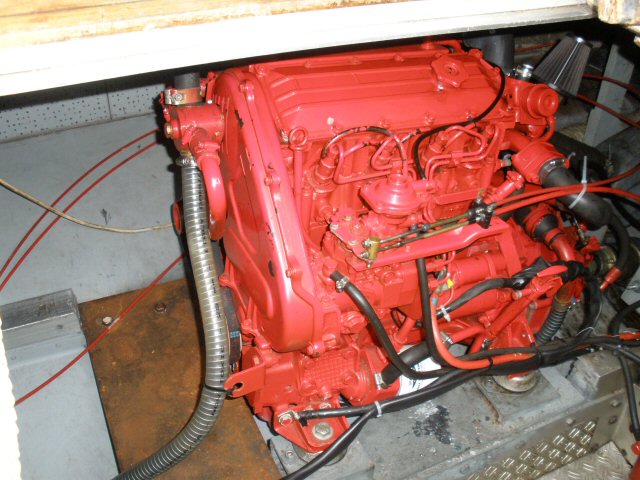

The engines were replaced in 2006/2007 for some FNM ATM100, 100hp each!!
I think, for a semi-displacement as the Laguna, it’s needs at least 150hp. That’s the downside of this configuration.
But if a had the choice of the original ones or the FNM’s I think this is not so bad because I will take the boat only at the inland waters.
The deck has the same problem as you describe “spongy”. Typically all the gangway feels like that.

There were some issue’s found when the survey inspected the Laguna.
The engines were 10 years older than the broker mentioned and almost all the electric equipment seems not to work.
That’s not a problem for me but I want that reflect in de price. He want not move a bit from the price that we agree on so I’m looking now for some other boot.
