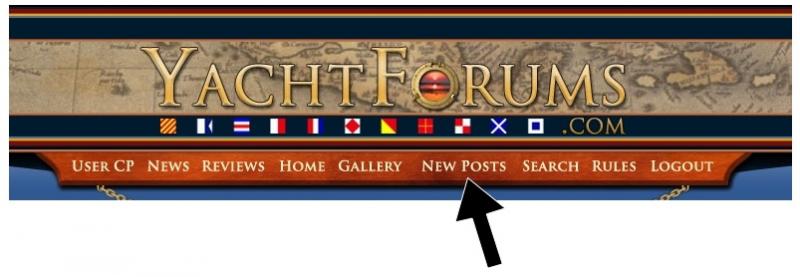

  19. AMG
    5,386
    Hi Far, since you brought it up, I have a question; Is it only me who have this header where you can check New Posts..?
  20. 84far
    84far Senior Member
    Dec 15, 2008
    794
    Brisbane, AUS
    I have it too, never used it till now. "Galileo G" looks great by the way, thanks YachtNews. I'll use it in the future for sure. Cheers
