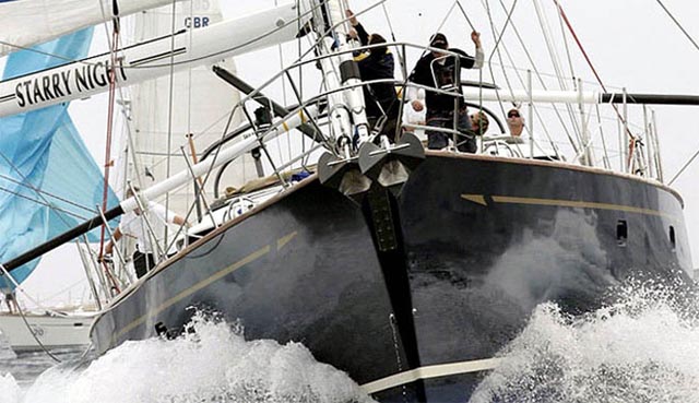

As far as I know this was one of the largest boats ever to have a full wrap on it.
Starry Night is reported as an Oyster 86.
Starry Night - Wild Vinyl Boat Wraps
