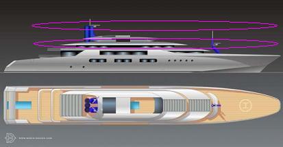

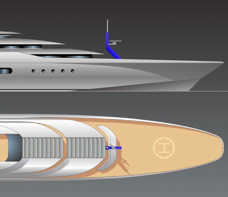

One reason to have folding masts is that the fore deck can be used for helicopter landing or as an emergency pickup area.
On the Triple Bling design I made a sculptural mast to free up the space...
Call me crazy; but I'm not too crazy about the forward radar location.
Name:  triplebling Radar Location.jpg
Old Phart is offline   Reply With Quote
Old 05-01-2011, 05:29 PM   #14 (permalink)
Senior Member
Join Date: Feb 2005
Location: Istanbul
Posts: 647
forward radar position
well, i cannot specifically comment for this design; but most of the very large commercial cruise ships or container carriers have a radar in the forward position. this is due to the fact that they want to be able to see the immediate vicinity in front of the bow..
nilo is offline   Reply With Quote
Old 05-01-2011, 05:58 PM   #15 (permalink)
AMG
YF Moderator
AMG's Avatar
Join Date: Jul 2004
Location: Sweden
Posts: 4,713
Quote:
On a 140 m (460 feet) yacht like this, you sometimes would like to have a close range radar in addition to the two main radars (working on different bands). The beam is not affecting any people behind the radar.
