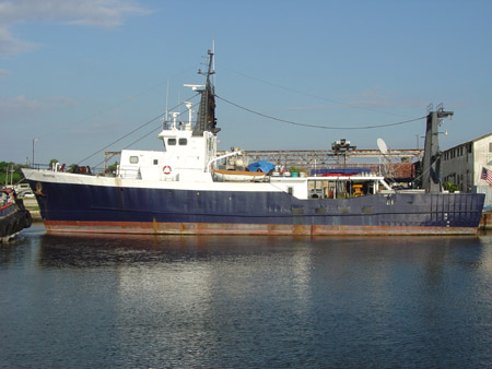

This is an ex-Canadian fisheries vessel that I became involved with.
The living spaces aren't too difficult; the engine room and peripherals will get your wallet's attention, though.
What are you doing down in 'the hole'?
